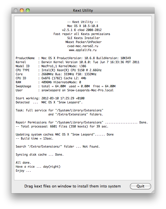

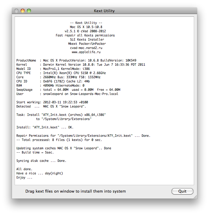

I have installed ATY_Init.kext 1.0.0d1 via KextUtility (KextDrop didn't worked for me) and then I turned off MacPro

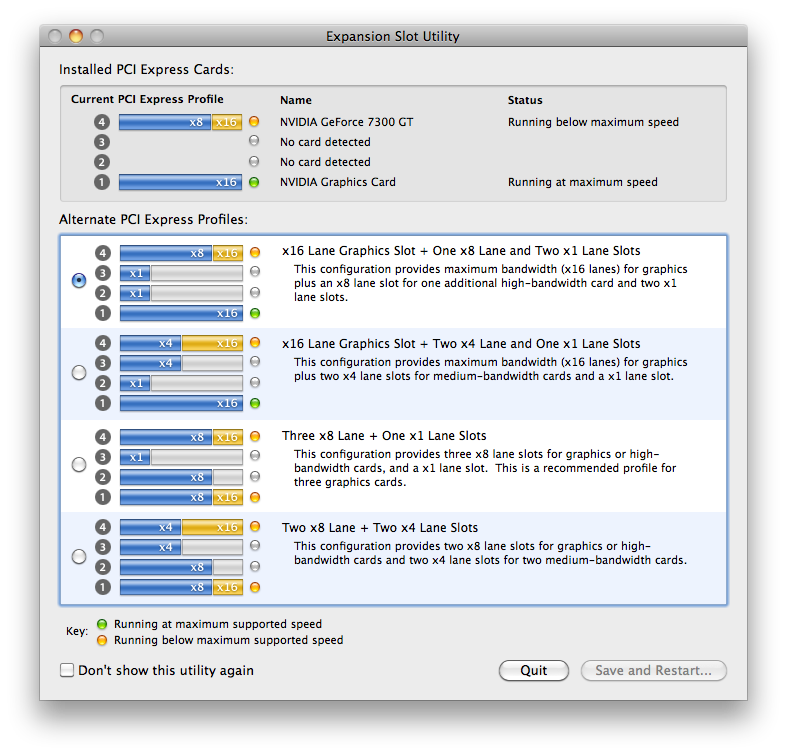

Next was moving GF7300GT from PCI-E slot1 to slot4 on wich Apple CinemaDisplay 24" is connected and finally I installed brand new GT220 in PCI-E slot4.

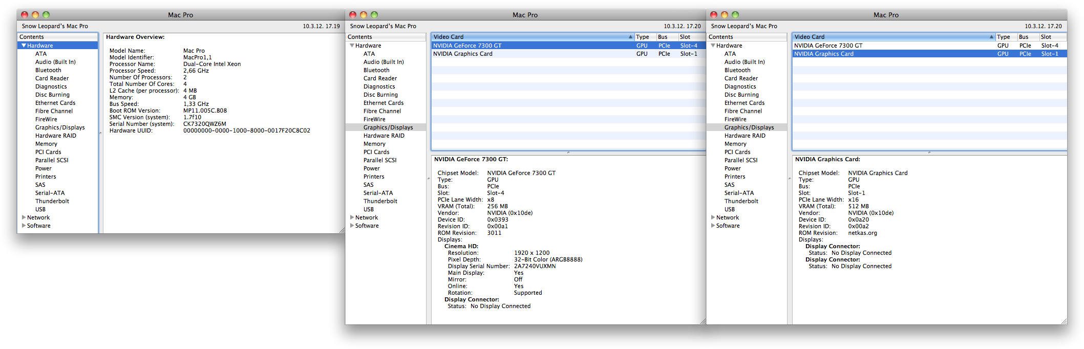

It's not recognising GT220 as I suppose it should, only as NVIDIA and with 512MB RAM

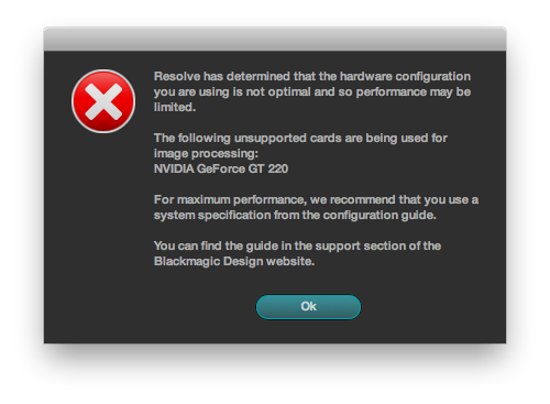

However my main goal is that I could make DaVinci Resolve Lite to work and it does ... Resolve recognises GT220 but it says that it is not optimal solution and there is no real time image processing but it works OK for first test ... will report after a while about performance in Resolve

3. is my pci-e configuration OK? ... would I get some performance in SL if I connect display to GT220?

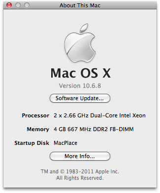

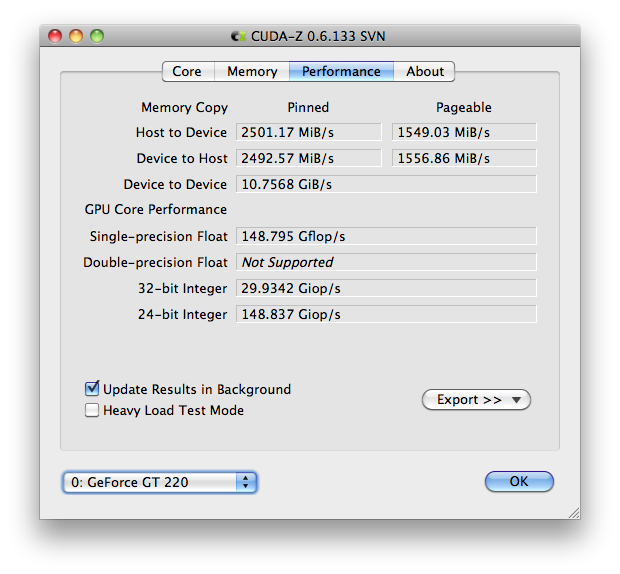

... and here is CUDAZ report ...
is this OK or not?

3. its ok

Good luck with that. Did we ever identify an actual problem that needs to be solved? The performance numbers are what he should expect. It is a low level card. The 7300 doesn't support CUDA at all.

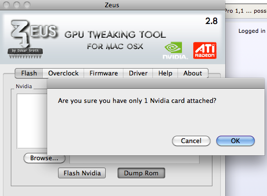

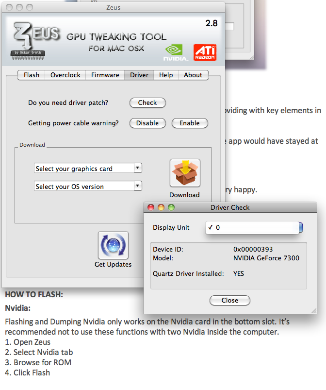

check for Quartz Extreme support by downloading zeus and going to Driver->Test button
Zeus is not recognising GT220 ... only 7300GT ... could not preform test ... altough there was not TEST button anyway
and on web it says that card needs to be in bottom slot ... what's that ... slot4?
it also says that I have only 1 NVidia card ... bug !?

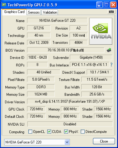

I hooked up GT220 to a PC and I saved BIOS from it ... both BIOS files are attached in GT220bios.zip file (GT220.ROM, GT216.bin)
GT220.ROM is backup from nvflash in DOS ... I also attached SCREEN01.TXT file wich is report from nvflash after successfully saved ROM file
GT216.bin is backup from GPUz in WinXP
now I am waiting for someone who knows how to enter that efi string ... if anything else is needed please tell me what and I will upload it as soon as I can ... tnx

I only want to add that efi string and I hope that when that is done it will display info about GT220 properly in SysProfiler. That's all I want.
Oh, all this just to fix the cosmetics?
I detailed in another thread how to adjust the RAM that shows up.
But you should see that the important info is known properly by the important programs.
And if you can update to 10.7.3 the driver update there fixes all these issues by itself.
