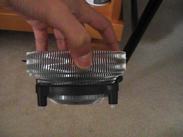

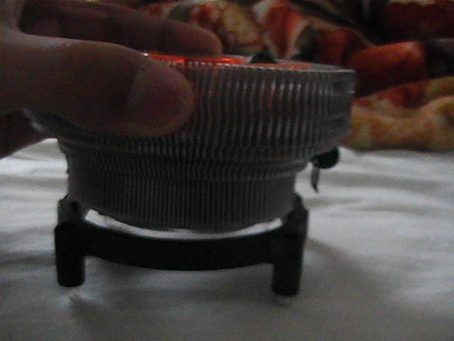

Okay, I got pictures :O
The first one is how its supposed to be, the black part attaches to the motherboard, and the fan attaches to the black part.
Second one: The fan is like that because it is "resting" on the processor, it is touching it. And the black part is attached to the motherboard, making the actual fan unable to reach the black attachment.

Maybe it's the pictures, but I'm still not seeing anything abnormal.
My experiences with these is that it's usually VERY difficult to get both sides of a fan assembly clipped down to the mobo bracket. It can take a heckuva lot of pressure to do it.
I'd recommend putting the motherboard on a towel on top of a table to do this. I wouldn't try doing it with the mobo already installed in the case.
See the two black clips on the (right) side of the fan? That clips onto the black part, which it can't touch because the processor...the actual processor is to high.
