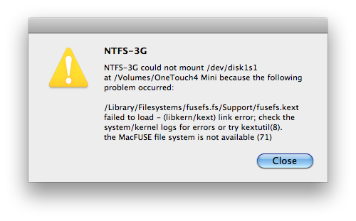

Hi GGjStudios - I encounter the following error while mounting my NTFS drive onto a mac. Could you please help me identify how to fix this? I'm 2 days old on the Mac and really need the help
Thanks
Thanks
Hi, ive had the exact same problem. Is anyone willing to help? Cheers.
