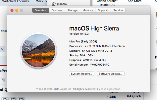

i have pretty much finished my 4,1 upgrade.

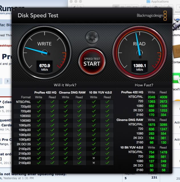

running high sierra on 5,1 firmware with twin 3.3 cpus
64gb ram and 2x pci-e ssd card in slots 3 & 4.

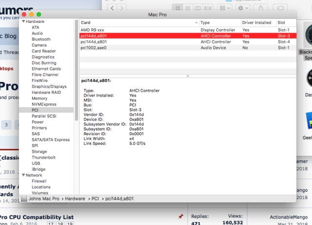

the last is giving me issues, the pics below should show it. i can only achieve 680 on the write speed?
every other install i have seen give read and write around the 1300-1400 mark.
i have enabled trim force so its not that, the 2 pci-e are not raid 0? don't know if this makes a difference.
i know it is still pretty quick by what the old brick originally operated at but id like to squeeze everything i can out of it.
any assistance appreciated.

if i were to raid0 the 2 blades am i right in thinking that would double the write speed?
that would explain it then🙂 thanks for the info.
Yes, for your case, the write speed should be around double, but more or less no improvement on the read speed, because slot 3 and 4 share use the same PCIe 2.0 x4 bandwidth.
