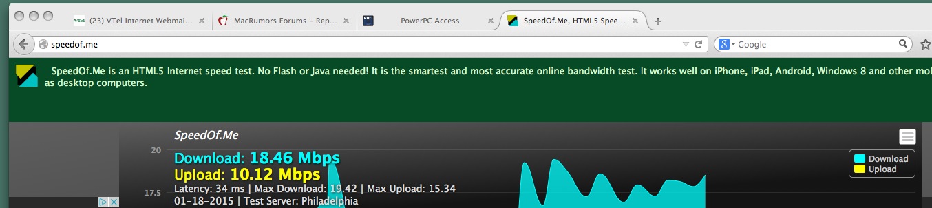

i just removed it and then took the broadcom card off it too. i then took the plyers and removed the mounts for the half length cards. i put electrical tape over the holes left from removal and reinstalled the broadcom card. it fit this time without those mid way mounts. i put the pcie card back in the machine but in a different slot. booted and it was there this time. so i then shut down and reinstalled the pcie card in the last slot as i wanted it and rebooted. its still there now and working great. all good now!
im not sure if it was the mounting touching the broadcom card or not, but im not going to question any more...
and im pleased with my throughput too...
