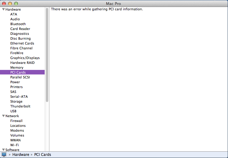

hi i have a gtx 680 4gb in a 5.1 mac pro but im getting a error that says there was an error receiving pci information is there anyway to find out if my link speed is 5.0 instead of 2.5 because i have the latest nvidia drivers installed
^^^^It's an known issue when using non-flashed (non EFI) Graphics cards. They report an error while trying to gather PCI card information.
I believe the Link Speed on 4,1 and 5,1 is full PCIe speed of 5.0 GT/s. A 3,1 Mac would only show 2.5 GT/s with a non-flashed card.
Lou
I am using a GTX 650 (non-EFI card) and see the same message that you are seeing in System Information>PCI Cards.
I suspect that this is the way it is with non-Apple cards (as Lou pointed out).
... is there anyway to find out if my link speed is 5.0 instead of 2.5 because i have the latest nvidia drivers installed
You can download OpenCL OceanWave & Bandwidth Benchmark V 1.61 from here. It'll show the GPU link speed. Another way is to download CUDA Mac driver from NVIDIA site and CUDA-Z. Install CUDA driver before running CUDA-Z, and click the Performance tab to see the link speed in the Host to Device and Device to Host category.
