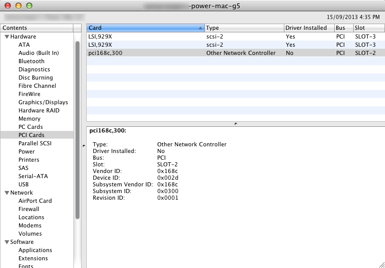

I installed the wireless card into my G5 and it's identified as "other network controller" by OS X
attachment.php
The card uses a atheros chipset, there are drivers for USB adapters, But I can't find any drivers for PCI extension cards.
I am sure the card will work under Ubuntu and Debian, but I want to stick with OS X for better software support.

I found kexts for my wireless card(unfortunately they require 10.7+), I have no luck finding any drivers for 10.5 PPC.
Did I just waste $15 or the card will only work in Linux?
I burned a copy of Ubuntu 21.04 LTS for my G5, booted it and the wireless card worked (sort of), but it can't display the signal strength properly.
I read that someone managed to get the card to work perfectly on a hackintosh by modding the io80211family.kext, it's possible to do the same on PPC?
