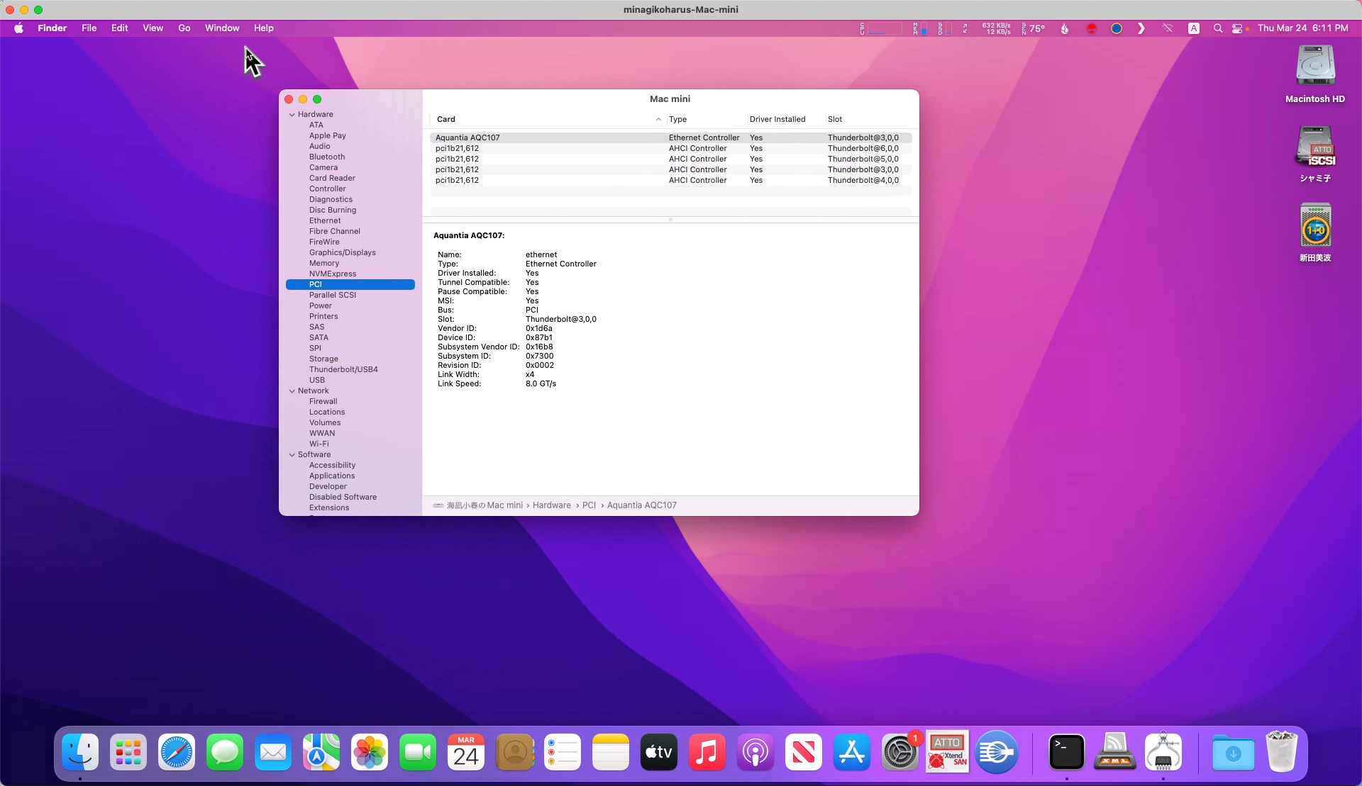

A Thunderbolt 10GbE NIC I use works fine on my M1 Mini - and it's a PCI device over Thunderbolt. It just matters if there are drivers for it or not.
