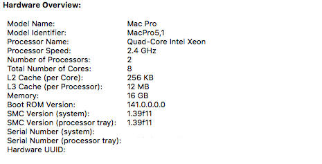

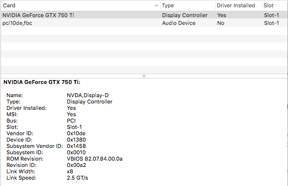

Did a search on this and was unable to find any related posts... Having an issue with a GTX750ti linking at 16x 5GT in Slot 1. I realize this was an issue with older Boot ROMs and cosmetic. Running High Sierra with 141.0.0.0 Boot ROM and the card is linking at 8x 2.5GT still. Some screenshot attached with details. Cl!ng is showing low scores as well. Performing the same as the High Sierra ROM was showing.
Card is a Gigabyte Windforce GTX750ti, PC EFI and works perfectly, sans bootscreens. Seems like it's underperforming. Any thoughts you all may have would be appreciated.
Edit: Running 387.10.10.15.15.108 web driver and the latest CUDA driver 410.130

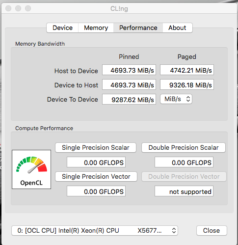

Other Pros I have will be running Pre Mojave firmwares, so link speeds will likely show at the reduced rate, but Cl!ing may tell otherwise. I know the speed problem was cosmetic in Pre Mojave versions.

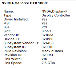

I also have a Mac Pro 4,1 > 5,1 with a 750Ti by EVGA, and I can almost swear I could not get it to display anything without installing the nVidia web drivers. Are some 750Ti's not kepler?
Looks like I am still on bootrom 140.0.0.0.0, here is my PCIe info.
Weird. Yours is getting the full 16x speed but only running at 2.5GT. Maybe these cards are just unusual in that regard.
I’m getting 8x and 2.5GT. Both slots 1 and 2 now with 141.0.0.0.0 firmware.
Yep, results are the same in slot 1 and 2. Any ideas wizards of Mac Pro forums?

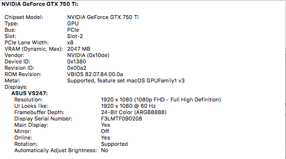

[doublepost=1549690486][/doublepost]Update: Installed the card in Slot 2 and these are the results... Same ol same ol. What the hell?

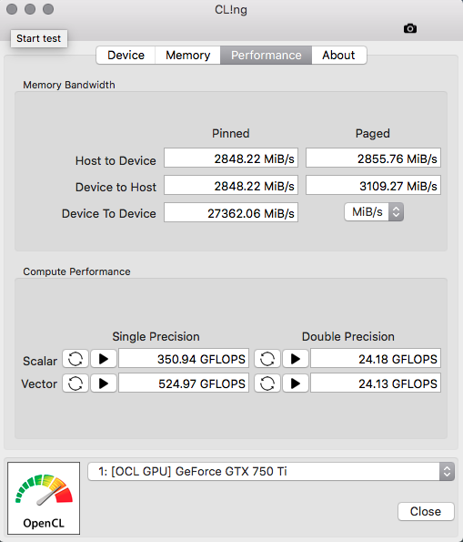

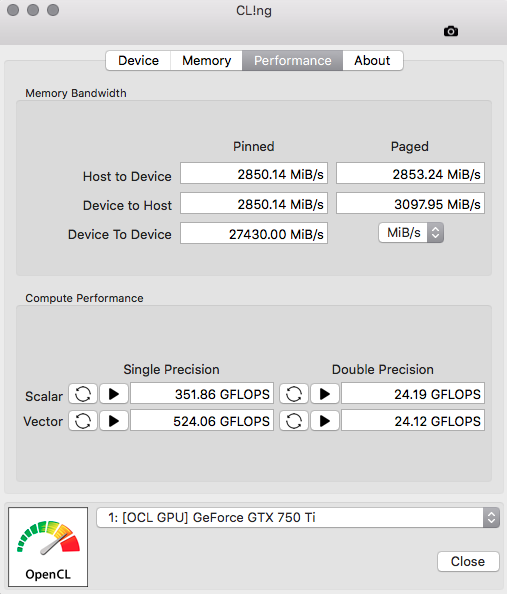

[doublepost=1549690689][/doublepost]Installed in the second 5.1 I have with an ancient bootROM MP51.007F.B03.... Exact same result, even with testing with Cl!ng... Realize that system speeds are cometic with this bootROM, but I think this card has an issue.

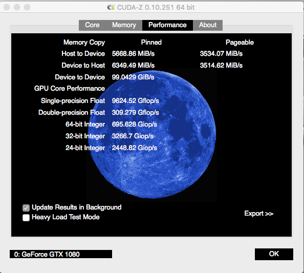

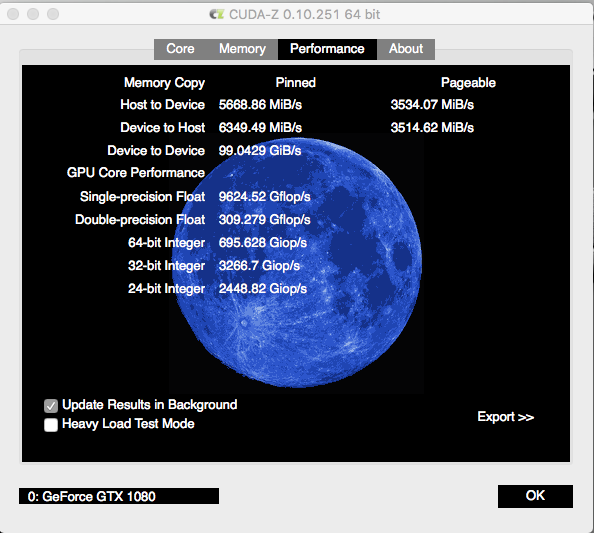

Have you folks tried CUDA-Z?

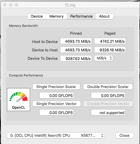

My results with CLng:
They are quite different. BTW, I'm showing:
Lou
Weird. Yours is linking at 16x and 2.5GT. I'm still only linking at 8x and 2.5GT. Thanks for sharing that with me. What bootROM are you running on yours? Also, your Cl!ing test seems to show the score for your CPU not the GPU under OpenCL. Going to try Cuda-Z now. Appreciate your feedback.
[doublepost=1549695425][/doublepost]I tried Cuda-Z... this card is beyond salvation in my opinion. Yours is linking at 2 to 3x the speed.
