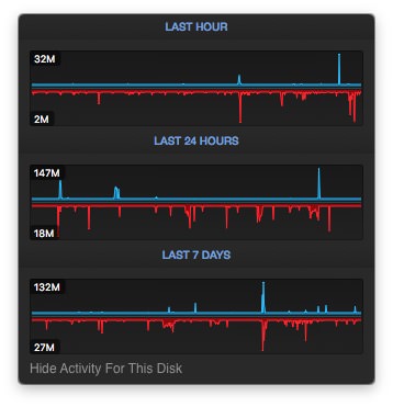

I do some photo / video editing as well. And this is my SSD usage history.
Despite the SATA II speed limit is around 250MB/s, and my SSD can run at 250MB/s (confirmed by benchmark). My real world usage rarely hit 50% of the bandwidth over the last 7 days. That's including some photoshop, and simple video editing. So, in my own workflow, even SATA II is not a limiting factor for me. Moving to PCIe SSD is more for fun if I do that.

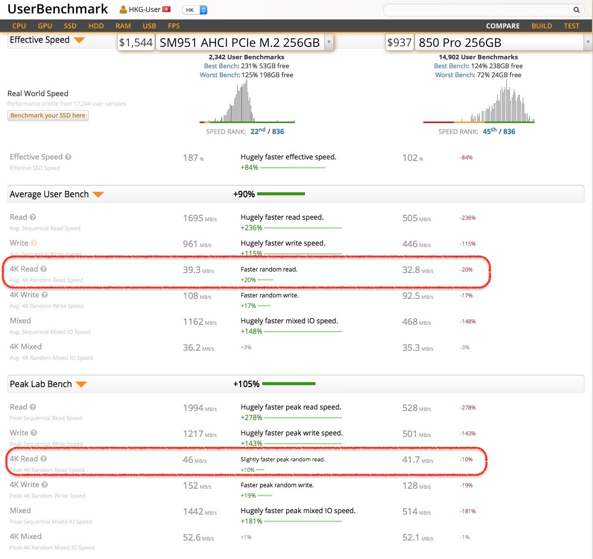

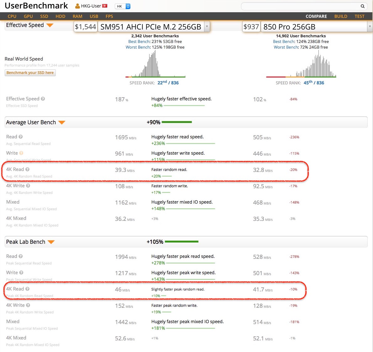

Reality is, PCIe SSD only able to achieve that crazy speed in sequential read / write. So, if you are not dealing with huge files regularly, you can hardly benefit from a PCIe SSD (AHCI).
For small files read write (e.g. 4k random read), there is only minor performance difference between a SM951 and a 850 Pro. Both are doing <50MB/s (for your info, HDD is about 1MB/s, that's why you feel the significant improvement from HDD to SSD. It's nothing about the sequential speed, but random read speed. Because OS are formed by thousands of small files, but not a single huge file)
In any case, PCIe SSD is faster, but most likely not that much as you are expecting (depends on your workflow). If your SSD history shows that you regularly hit the 250MB/s limit, then a SATA III card or PCIe SSD will help.

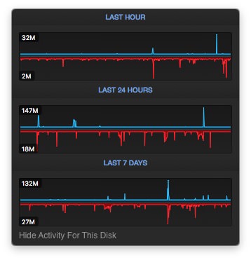

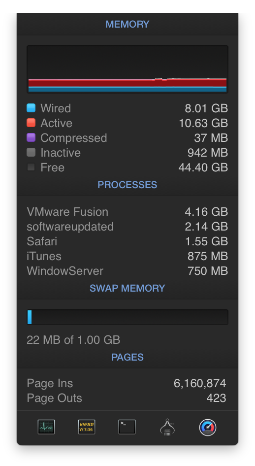

One other thing to consider is virtual memory. On my very old MacBook, I was limited to 8GB RAM and I often found the system using virtual memory and lots of page outs. Having my SSD on SATA 2 definitely had an impact on how sluggish everything felt when this happened.
One of the reasons why more modern Apple laptops get away with having only 8GB RAM or less is that they use very fast SSDs which greatly lessen the impact of virtual memory.
