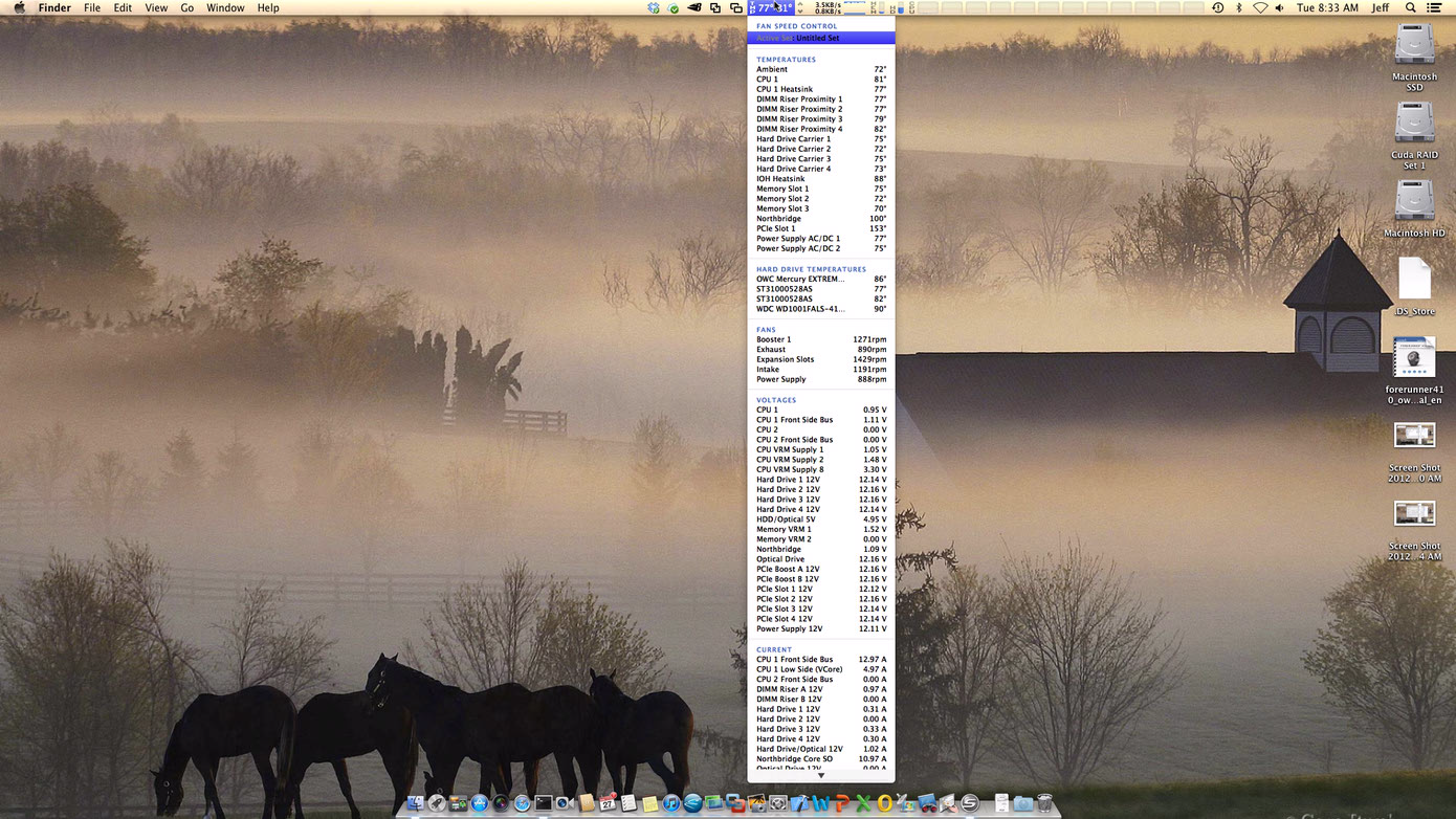

Concorde Rules - I honestly don't know what it's reading. I feel cool air coming out of the back on the unit. Here's a screenshot of iStat Menus

The expansion bay fan does seem to think there is something hot in there and a 5770 would not generate much heat at idle.
I would recommend you fully remove everything and give it all a good clean and also make sure the 5770 on-board fan is spinning well. It should be drawing air from the PCIe bay, passing it over the GPU and exhausting directly out of the back. If there is fluff and dust in there, that airflow would be impeded and if the fan was spinning poorly, again the temps would rise.
At least you have plenty of options for replacing the 5770 cooler if it is defective.

My istat Menus pulldown as in your screenshot shows four memory slot temps instead of three, then northbridge, then the two power supplies... no PCI slot temp.
I'm on a 2009 with 2010 firmware, so maybe there is actually a different sensor setup on the 2010 hardware that I don't know about.
