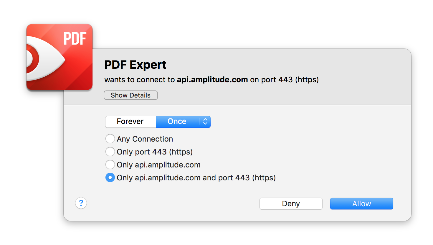

[doublepost=1463324502][/doublepost]UPDATE: I just tried the Little Snitch tool and there was only one connection that PDF Expert tried to make, which you can see in the attached picture. I denied that connection, but the speedtest was reporting slow download speeds just as before. Closed the app and everything went back to normal again...

[doublepost=1463324502][/doublepost]UPDATE: I just tried the Little Snitch tool and there was only one connection that PDF Expert tried to make, which you can see in the attached picture. I denied that connection, but the speedtest was reporting slow download speeds just as before. Closed the app and everything went back to normal again... View attachment 631372
I'm sorry to hear that. Last chance try to deactivate hand off, because Readdles implementation seems a bit advanced: https://readdle.com/blog/2016/03/pd...devices-retweet-to-get-15-promo-codes-macios/
