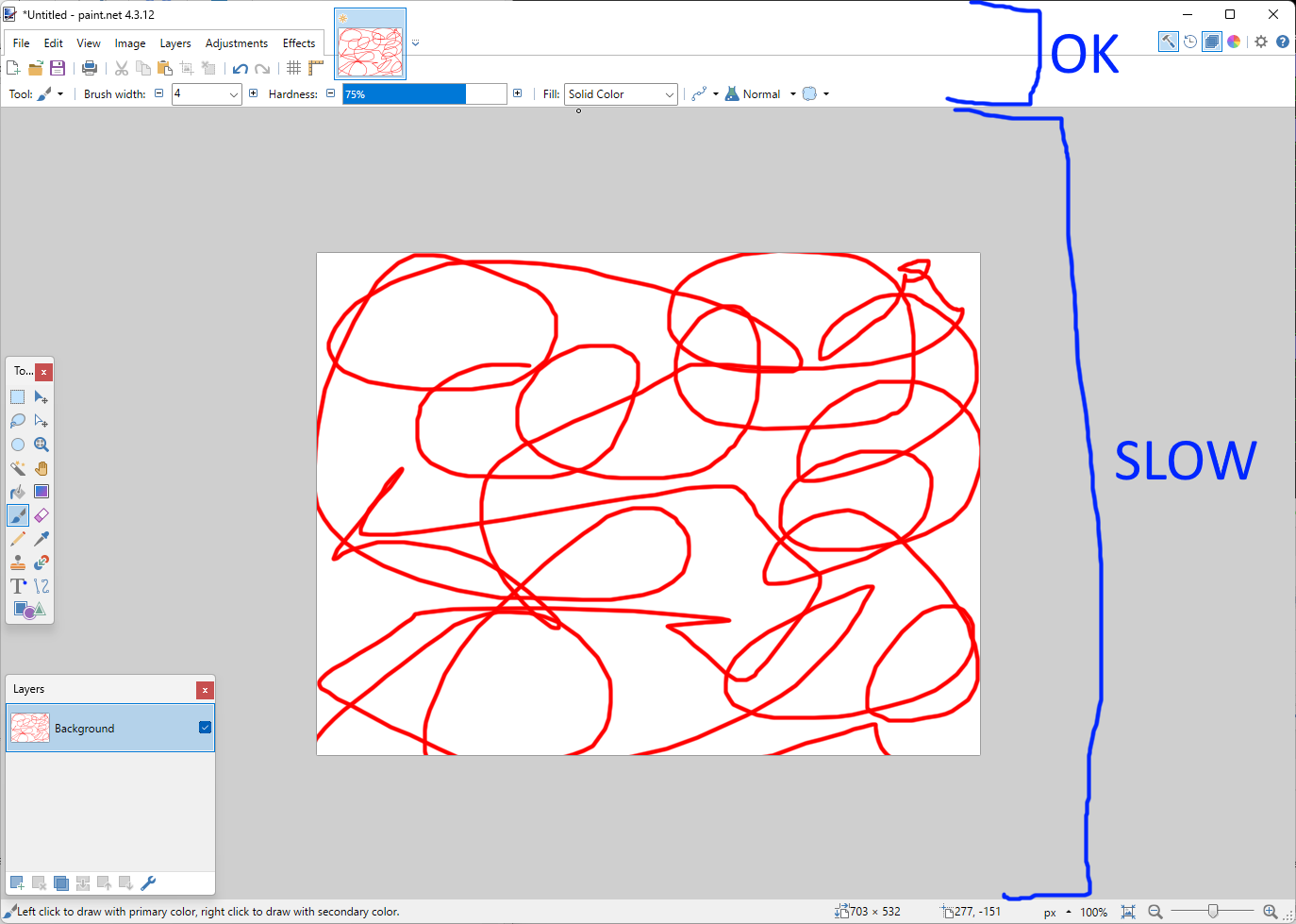

Recently I created a Win11 ARM VM on VMWare Fusion, for the sole purpose of running Paint.net. It works, but I am experiencing a strange performance issue.
Basically, the mouse response is smooth when I'm in the toolbar and menu area at the top of the screen. But once I move the mouse below that, response becomes terrible, like maybe 5-10 FPS at most. It doesn't seem to me like just moving the mouse around within the drawing area should be such a strenuous operation that is slows down so much. Is this explainable and/or fixable?

I don't have a solution but can confirm the same behavior on a similar setup (Win11 Arm on VMWare and M1 Pro).
Interestingly, the only way I noticed the framerates don't drop is when I'm using the pencil tool. Seems very smooth. But everything else, like the paintbrush tool, or selectors, all lag a lot like you describe. Unfortunately I don't know if there's a fix.

I recall something in the VMWare forums recently to the effect that Fusion doesn't pass any GPU acceleration through at all. Speculation - the painting app is drawing the canvas viewport area directly to the GPU - ie that part of the screen is direct GPU output. I'd be interested to know if the slow mouse response happens in the layers palette - if you made that really big to see if it's a crude divisor between the top and bottom, or if it's the canvas viewport specifically.
That's a pretty good hypothesis.
I will try that, although things seem pretty zippy on the M3 so I don't know if I'll be able to draw any good conclusions.
Well, I updated VMWare Tools and now my performance is back to crap. 🙁
BTW mouse performance is fine in the layers palette.
(I'm now on Fusion Pro 13.5.2, but the performance regression happened while I was still on Player 13.5.1).
UPDATE: I tried turning off 3D acceleration and whaddya know, performance is much better. ¯\_(ツ)_/¯
