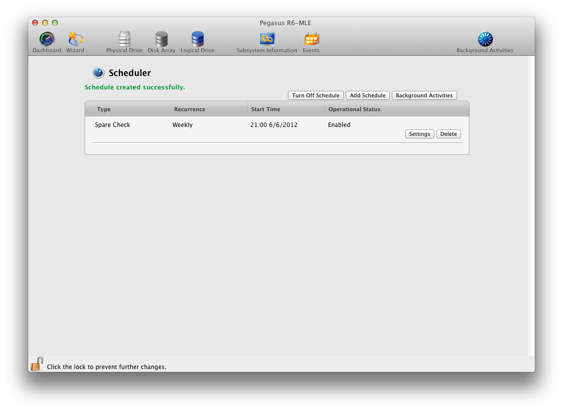

I've scheduled a task to run tonight at 9PM so in 12 minutes, I shall update you if it works. I've quit the Promise Utility

I've confirmed WITHOUT the utility running it will NOT run scheduled tasks. I set one up at 9PM to check the redundant drive and it did not run. I setup another for 10PM with the utility open and it did run.
