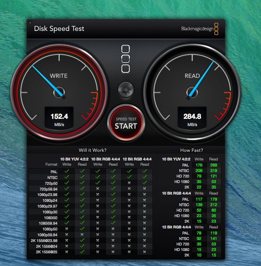

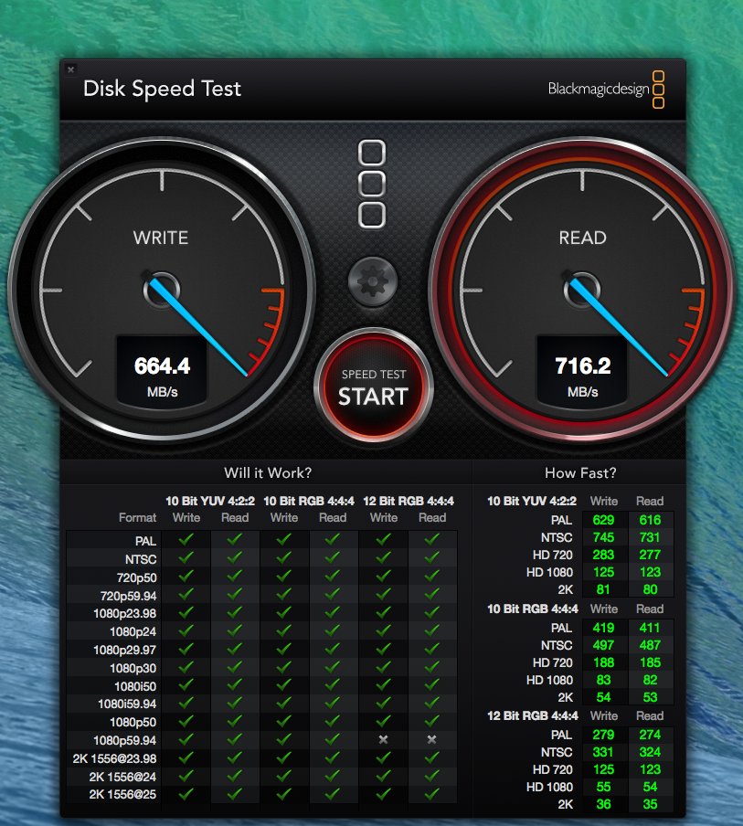

Hey,
sure, good question!
Just take a quick look at the actual speeds of both systems. As you can see, the drobo is a hell of a lot slower than the Pegasus!
In real world, it's just impossible to playback a 1080 exr filesequence from the drobo stutterfree. Editing from the pegasus is suuuper smooth. I can even play back red files at 1/2 debayer setting in real time on my late 2012 imac!
Lightroom and Aperture lib are both on the pegasus as well, just so much faster scrolling through the images than on drobo.
The drobo is just hosting my itunes library and old projects and stuff. It's basically my archive. It's like a huge, expandable USB 3 disk with redundancy to me. I wish I could sell both and just get a Pegasus2 R8 for the new mac pro. But no one wants the drobo. And the pegasus is fast enough for most cases.
Just look at the table in the speedtest. You can clearly see what the drobo will be able to playback and what not.
