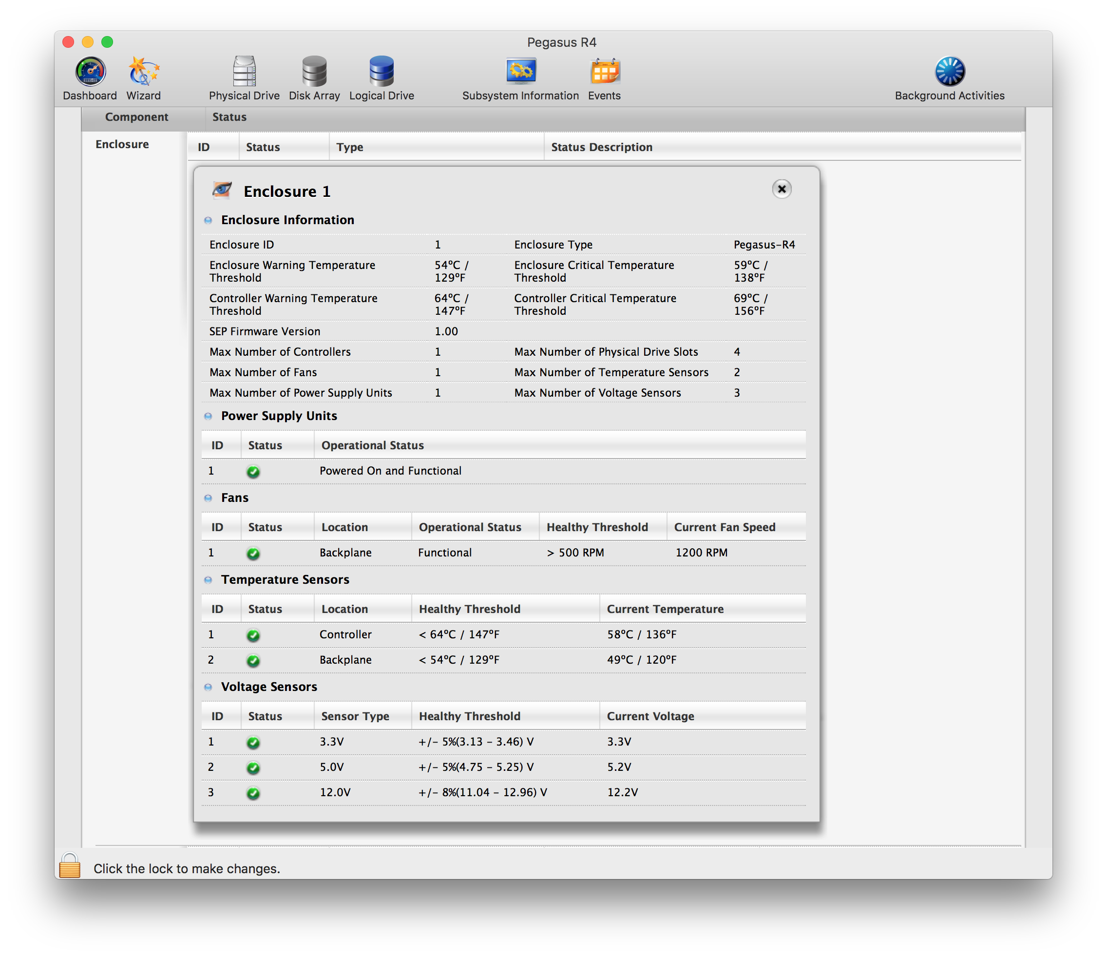

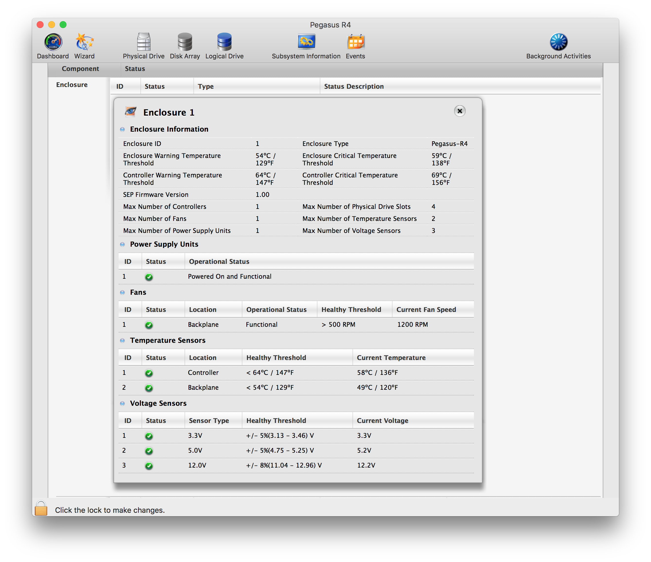

I can report that the Promise Pegasus R4 (first version, 4 drive bays) with firmware 5.04.0000.61 is compatible with Toshiba's 8TB N300 disks (Model "TOSHIBA HDWN180"). The drives worked out of the box; SMART values are properly reported in the Promise Utility.
Initial synchronization for a RAID5 (32TB, 24TB usable) took 36 hours.
Noise and temperature are within acceptable ranges.

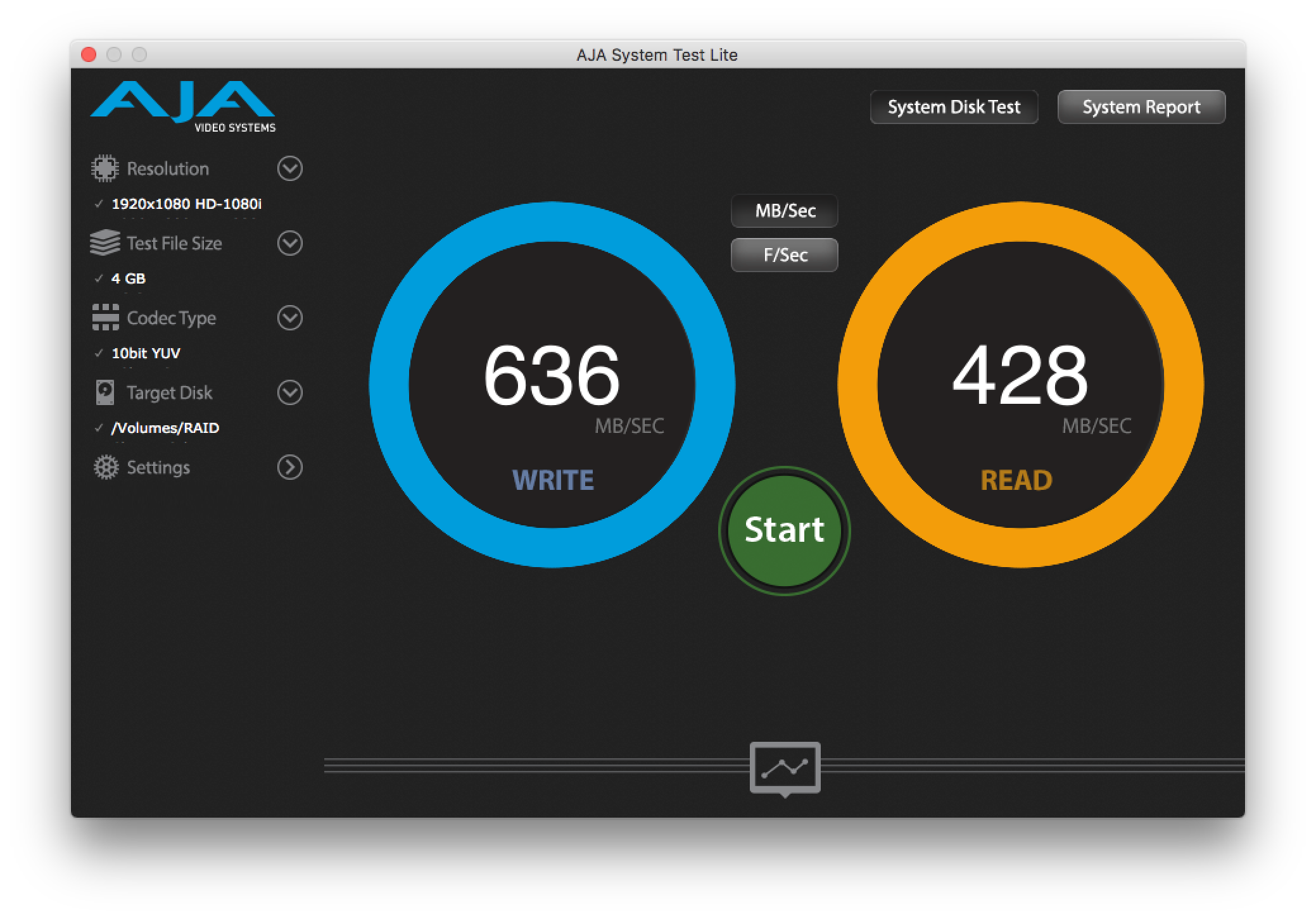

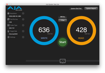

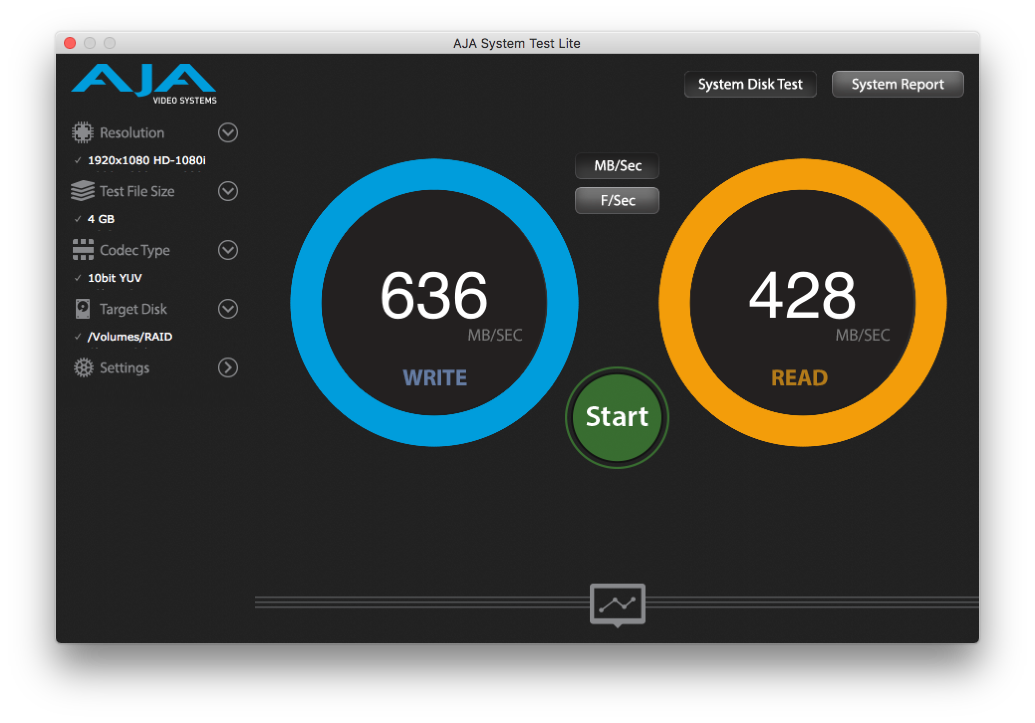

Performance of a single drive in the Pegasus: 230MB/s read, 180MB/s write
Performance of a RAID5 (4 drives): 420MB/s read, 640MB/s write
Screen Shot 2017-06-23 at 17.49.58.pngScreen Shot 2017-06-23 at 17.51.19.png
View attachment 705433View attachment 705434
Update: Everything is still fine after running the Pegasus for almost a year.
Update 2: Two years in. No problems whatsoever. Rock solid.
