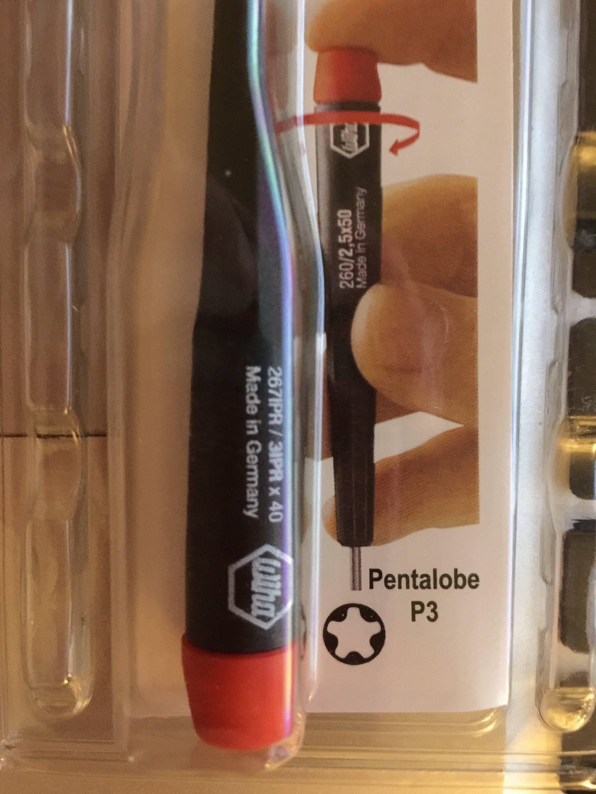

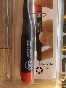

Can you post a pic of the Wiha #3, particularly the area with print on it indicating the size?
I recall someone saying there is a P3, which is a TS4; and people have been mixing up the numbers and using them interchangeably.

I'm not home to get you a photo, but there is a photo here of the set I bought through Amazon.
http://www.amazon.com/Wiha-26794-Pr...ewdriver/dp/B00GY8VQQE/ref=pd_sxp_grid_pt_0_1
If you hover over the photo to zoom in, you'll see one labeled 267IPR / 3IPR x 40. That's the one that works. It may be part number 26763 but when searching on that in Amazon for a single driver, the photo shows 4IPR, so who knows what you'd get if you ordered it.

This is what I received. It says 3IPR. It's just too big.
I doubt apples own specs would be wrong. Both Apple and iFixit say P2.

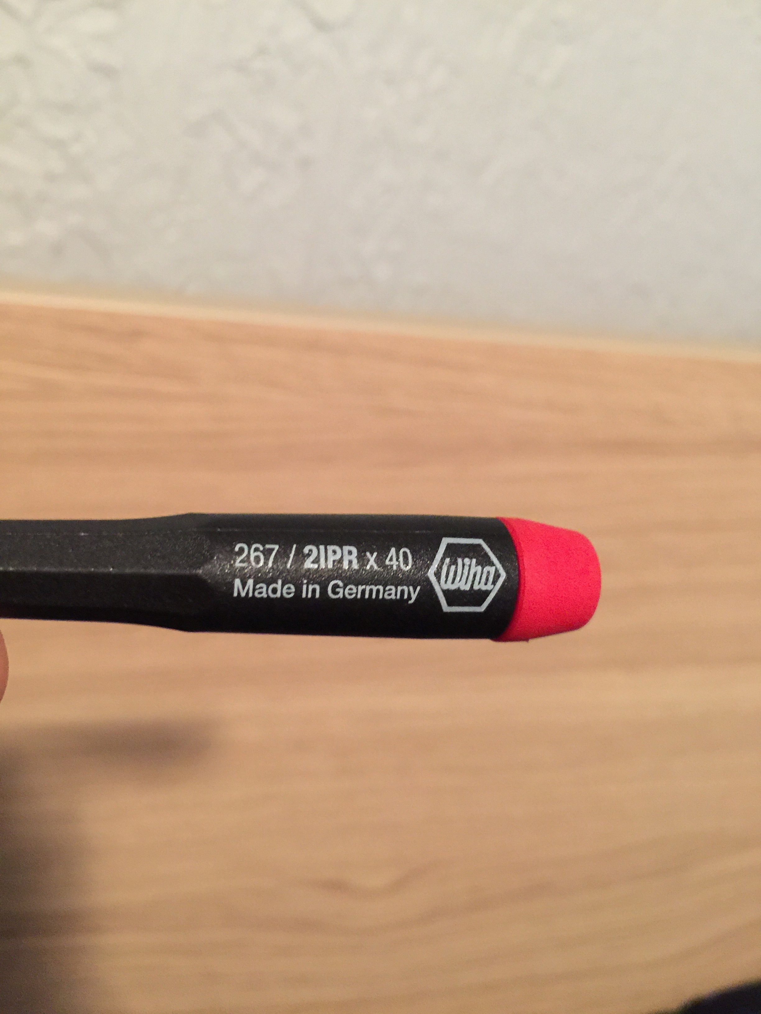

The one from the Wiha set that worked was the 2IPR.
The 3IPR wouldn't even fit.
My screws though are painted/anodized and the coating might be making my head sizes a little bit tight so I can see where the 3IPR might be able to be used with naked metal screws or even with genuine Apple screws (this adapter came from China).

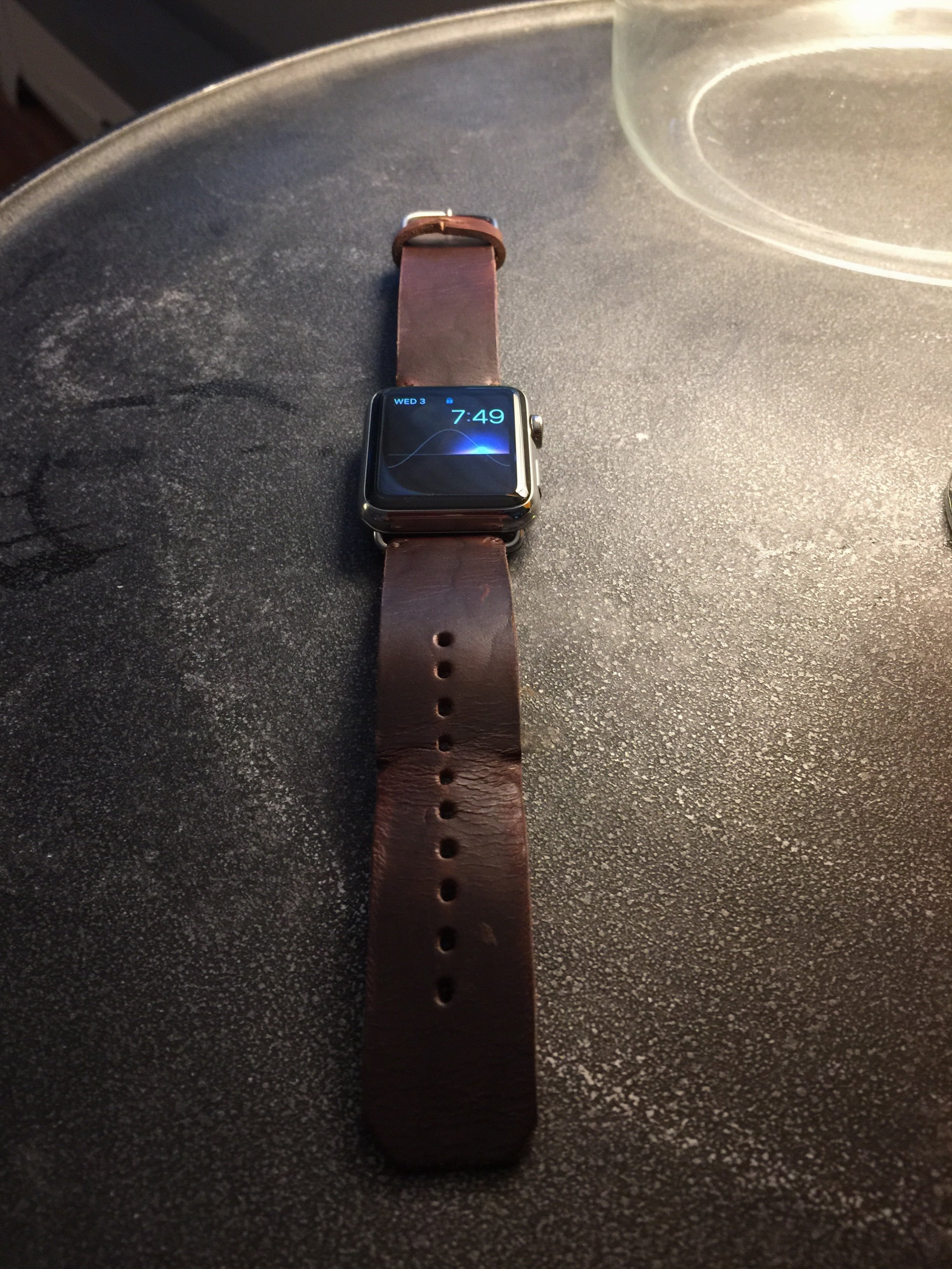

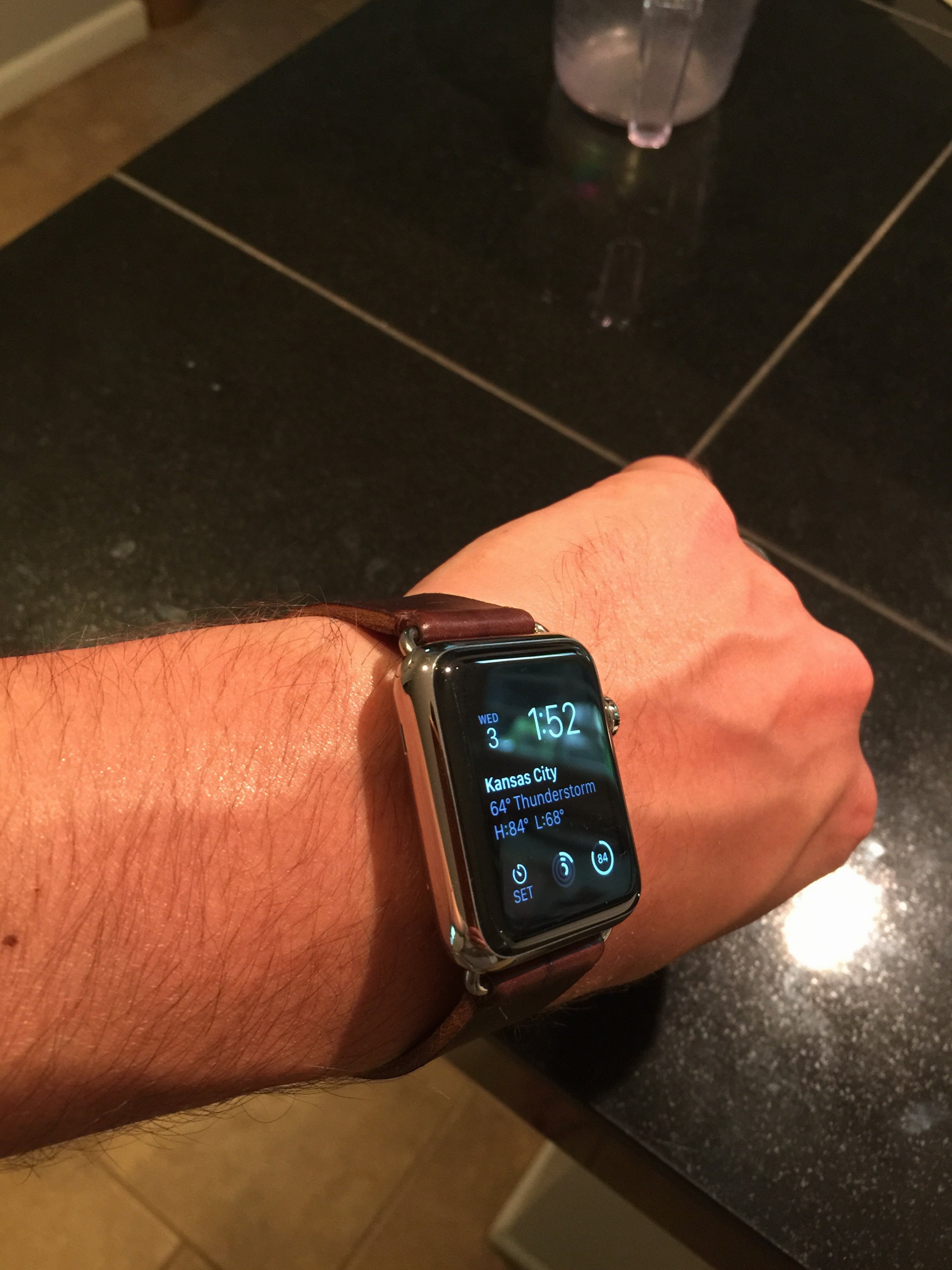

Thanks for the feedback BigCK. Can you post more pics of that strap and info on where you got it? It looks great!

Ok, was worried the same P3/3IPR I ordered from Amazon would not fit the Apple Watch's Black Classic Buckle screws based off what November Whiskey had said but to my surprise it worked!
I used the very same on my classic buckle (I have tried it on two different of Apple's Classic Buckles and it worked perfectly.

Here is the link for my band. It's nice, but the buckle isn't super solid. But Horween leather is amazing. I ordered another one also.
https://www.etsy.com/listing/233555960/two-piece-tan-chromexcel-horsebutt-watch
https://www.etsy.com/listing/194521711/made-to-order-22-mm-natural-horween

I just received my Wiha Pentalobe P2 today (IPR2). I can confirm that this is a perfect fit for the OEM Classic Buckle screws.
The Wiha P3 is too big, and the iFixit P2 is too small.
I don't know why others have had different results, but I agree with Apple's own specs to use a P2.
Also, the Wiha P2 is EASY to use. There is ZERO struggle to line anything up or getting it to fit. It is a PERFECT fit.
If you are struggling like others have described, you probably have the wrong size or a poorly built one.
