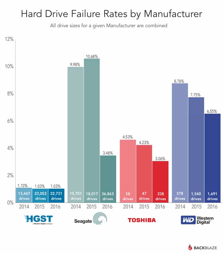

Disk reliability (particularly for Seagate and Western Digital) is improving a lot. See the latest Backblaze disk reliability report:
https://www.backblaze.com/b2/hard-drive-test-data.html

Hard drives keep getting bigger, faster, and cheaper. They have not gotten more reliable. In recent years it has hung out around 1-4% on average, but certain brand/models can go up into the 8-10% range. Occasionally as high as 13%!
Certainly that was the case in the past. But the latest Backblaze data seems to show a lot of improvement. The worse performing drive failure rate was 2.2%. 7 of the 15 drives have failure rates in the 0.* % range.
https://www.backblaze.com/blog/backblaze-hard-drive-stats-q1-2019/
But drives do fail. If I remember correctly the Backblaze folks indicated that failure rates spiked when a disk was first installed, then dropped, then rose again as the drive reached the end of its lifespan. I purchased a very expensive HGST helium enterprise drive. It failed. They sent me a replacement. That failed too ...
Reactions: brobson
Yep. That info was in a chart...fairly far down on my link.
And yes, the good drives are in the 1-3% failure rate. But that is not all drives...there are usually a few bad eggs each year or two, and those do occasionally spike to over 10%.
And yes....infant mortality rate in hardware is a real thing.
