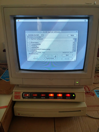

Evening y'all,
A while back someone gave me an old Performa 450, a complete system, including all the original literature, disks, a SCSI CD-ROM drive, a game pad, modem, (lost track of the printer), and a few extra bits of software and such.
I decided to go try it out today and it doesn't want to boot. I fired it up, but I see nothing in the display, and no status sounds or beeps, just the HDD spinning up. Floppy doesn't try to read or anything either.
Where's the first place to look in trying to get this thing firing up and booting?
Also, if I can find (or build) an adapter to get that to work on a VGA monitor, I could actually bring it home and try to get it working here instead of an hour away.
Aside from newer OS X systems, I'm pretty much a mac noob.
Any ideas?
Should have done a search

Okay guys, had a busy last few weeks, what with the break up and move out and all. Anyway, now that she's gone, I have some room so I brought the Mac down to my apartment. The power supply checks out within voltage tolerances. I'm going to order new caps, since it's $3.48 worth of parts. I'm ordering the same aluminum types they used in manufacture just because when I repair anything I try to get as close to OEM parts as possible. I'm also trained (not yet certified though 🙁) to IPC 610 standards, so even though my equipment sucks, I'll try to get pictures of a proper removal and reinstall procedure for these caps. One link I saw showed someone cutting them apart and peeling them off. That can absolutely TRASH the traces or lift a land (pad) if you clip wrong.
I talked all that **** about lifting pads and what did I do? Lose three. Any tips on pad repair? They've not just lifted, they've gone.
edge of trace
you can scrape off the edge of the trace, clean it, and solder a small dot on it that should be ok as a repair.
I've been having a tough time trying to get solder to stick to the trace. I picked up one of those conductive pens, I'll see if I can use that in some way to my advantage.
Got it going! Thanks for the help guys. I might end up in another thread trying to figure out System 7.5, but hey, we'll see.
