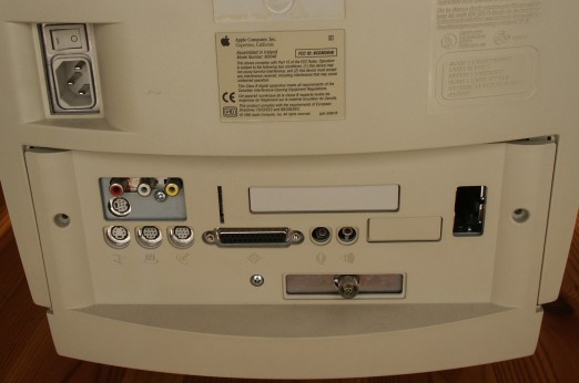

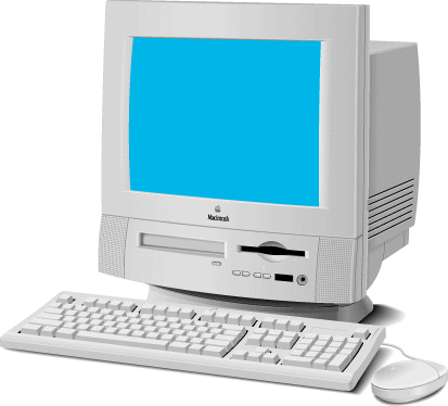

The 5200 is an all-in-one Mac. It doesn't have a monitor port. Lemme see if I can find a pic...

Yes, but there was an option to get the monitor port upon purchase, or as an upgrade card, at least according to mactracker. Anyways, I thought that the internal port was also the same connector? It would make sense considering that the monitor inside of the computer was likely just a built in version of the apple external monitor at the time.

I dont think this model has the RCA plugs on it like the photo above showed. I have 2 Imac G3's as well as a Beige G3 Desktop that i want to Overclock and upgrade. With the Performa is there anyway at all to maybe get it running OSX? I just want to do something with it as its just collecting dust and my parents are slowly loosing patience as my room is pretty cluttered with my PowerPc macs as well as some Pentium series PCs. Is there maybe a way of over clocking this beast? And sadly i am familiar with the fact that this machine is considered apples worst machine. You pick the damn thing up from the sides and it cracks and upgrades are to a minimum.
You can put in an AV card that will give it RCA input. It cannot run OS X. You can clock chip it by adding a crystal chip to it that will bring its CPU speed up about 10Mhz. Not worth the increased instability that model already has.

The optional monitor port only allowed mirroring of the built-in monitor and was limited to 832x624.
