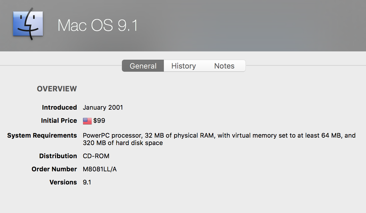

I have a couple of 6500s and they top out at 128MB of RAM, which doesn't leave a lot of room for OS9. I'd say stick with 7.6/8.1 or maybe BeOS 4.0
9 runs fast on like 64MB. I'm almost positive my old one only had 32MB and I never had a problem running 9 on it. I took it all the way to 9.2.2 with OS9 helper.
I have OS 9 on a PowerBook 500 PPC with 40 MB and the system works well (with RAM Doubler). Only Problem ist Classilla who has problems with only 40 MB physical RAM
