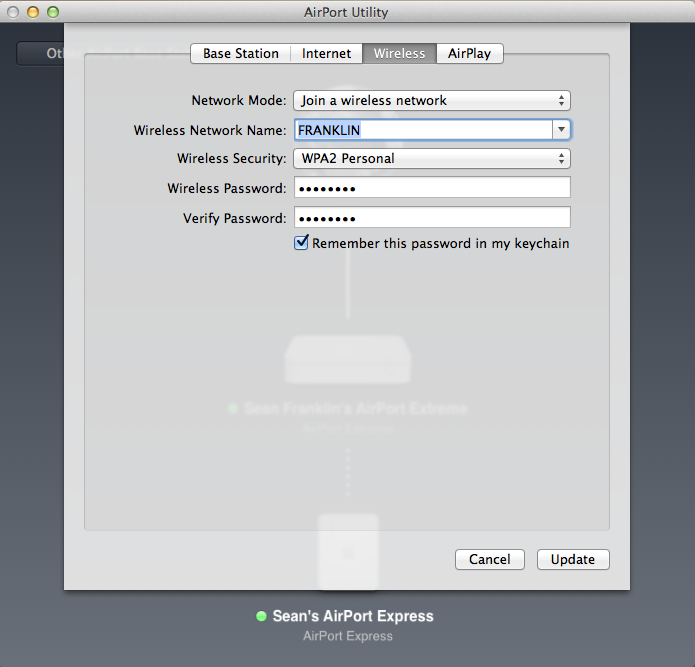

I have the first-gen Express, but I assume the 2nd gen can function the same way - I set up my 1st gen as a "Client" on the network. If your wireless range is adequate with the Extreme alone, you shouldn't need to use the "Extend" feature; just let the Express act as a client for your printer (I use mine just for speakers).
The 2nd gen manual doesn't seem very clear on whether "Client" mode is an option like it is in the 1st gen (see page 15) so I'm not positive this is a workable solution, but someone else may have more experience with the 2nd gen Express.
Edit: Just to clarify, here's the page on the AirPort utility for my Express - set to "Join a wireless network" instead of "Extend a wireless network"

as the last poster said, if you don't need the range extension, have the express join the main.
