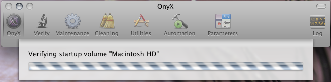

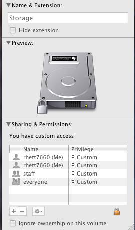

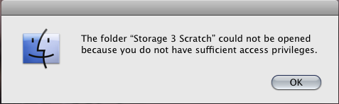

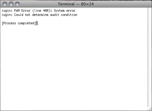

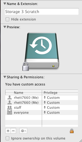

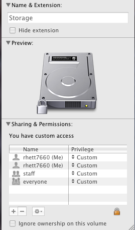

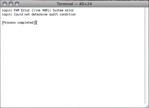

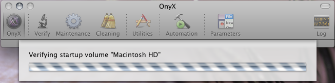

I am in a little perdicament. I changed my permissions on a folder(s) and now I can't access any of the hard drives on my computer. I have been trying to run OnyX for the past hour and it is just spinning on Verifying startup volume. I have tried to go into Terminal but this is what I get. See screen shots. Any suggestions?

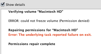

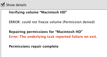

I have also tried the disk utility but I get the following errors also. See screen shots.

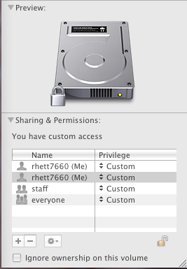

Also, I can't use Time Machine because it is on one of the internal drives and it is access denied also. So I can't go backwards in time with that either..
Since I couldn't run Permission Repair under my user name I am now trying it under root. However, the etstimated time is 14 hours!! 😱😱
Does this seem normal? I am also seeing a lot of the:
ACL Found but not expecton on "Library......
I have tried to updgrade to SL, but that is not working either. Does anybody have any suggestions on what I can do for this?

if you pull up the advanced options in system preferences accounts is your user id showing up as 501? if not you can try changing it back
also try logging in as root and correcting permissions on macintosh hd

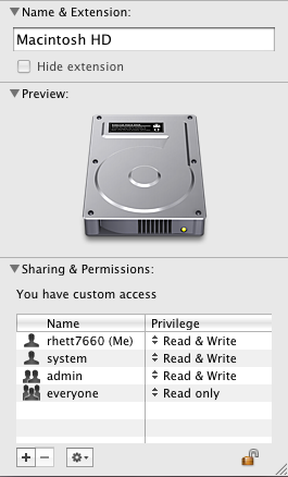

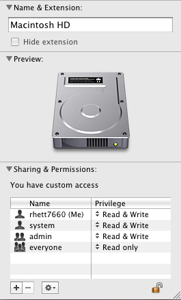

I changed permissions on the Macintosh HD drive......
Okay, that would explain it, as that is permissions on the entire system and not just a folder as you previously indicated.
You can try installing Leopard or Snow Leopard onto another volume and then repairing the disc from that other installation, if the other methods mentioned don't pan out.
What exactly did you do when you changed the permissions? Apple is usually pretty good about preventing users from being able to accomplish this sort of thing.
I was syncing some files via chronsynic. Some of the files were putting up errors... I changed the permissons under the "get info" tab for my user name to "Read and Write". Once I did that it locked everything down.
My system is no longer able to boot up. It goes in an endless cycle of going to the white screen, makes the start up noise and the recycles again.
I was in the process of copying over files to do a fresh install. These were just files on the disk that I was using. Nothing that had to do with the OS. I had about 100+ files that would not copy over so I changed the permissions on my name under the "get info tab" and this is where I am at....
Unable to boot at this time. I was going to try and install it on a firewire drive I have but I can't boot up any more.....

The problem with the change of read/write for you, the superuser on the box is that you probably lost root ownership permissions on the file system when you made that change. Either that, your you somehow changed your group id number, etc, which rendered the system inoperable.
I would really be surprised if this was doable when logged in as a user, even as an administrator. Did you log in as the root user itself when you made this change?
I was logged in as the Main user on the machine which is also set to administrator.

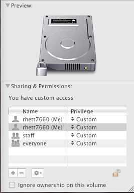

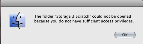

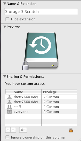

Ok.. I was able to get SL installed and up and running. However my other three drives are still showing locked.
What would you suggest?
It is showing 501...
I'm guessing you ran the series of permission settings against the drive as indicated somewhere in that thread?
Yup.. I was able to do the following on each drive, worked like a charm.
Code:
sudo chflags 0 /Volumes/Volumename
sudo chown 0:80 /Volumes/Volumename
sudo chmod 775 /Volumes/Volumename
sudo chmod -N /Volumes/Volumename
