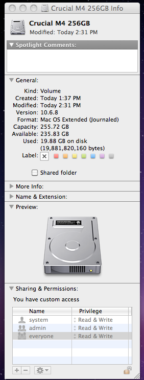

Why does it say I have custom access? How do I fix this? I seem to be having problems not being able to have full access. (I am an administrator account.)

It looks like the ACLs are a bit borked. If you don't care about other users, you could disable permissions on the drive entirely.

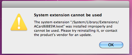

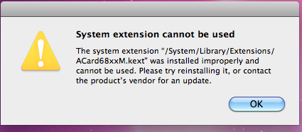

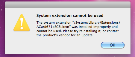

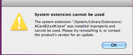

Here are my permissions now... (i think?) and I am also receiving a set of ~200 errors similar to the attached pictures.. What is the solution to this?

Is there a way to change the permissions for all files? I know there's a way to do it in terminal but I can't seem to find the exact line that I am supposed to answer.
Why don’t you repair disk permissions in Disk Utility?
That may fix the kernel extensions, but it won't touch the permissions at the root of the drive.
You absolutely do not want to do this on a boot volume. If you have succeeded, the proper course of action is an OS reinstall with a restoration from backup. You'll never get the permissions right otherwise.

I created a second account, and transferred my user library files over to that account. That fixed the permission problem. As for the errors, I don't know what they came from, but I went digging with finder to find these 22 files, and specifically deleted them and left everything else intact. Finally, it appears that my computer is completely back to normal and I have successfully installed my SSD.
