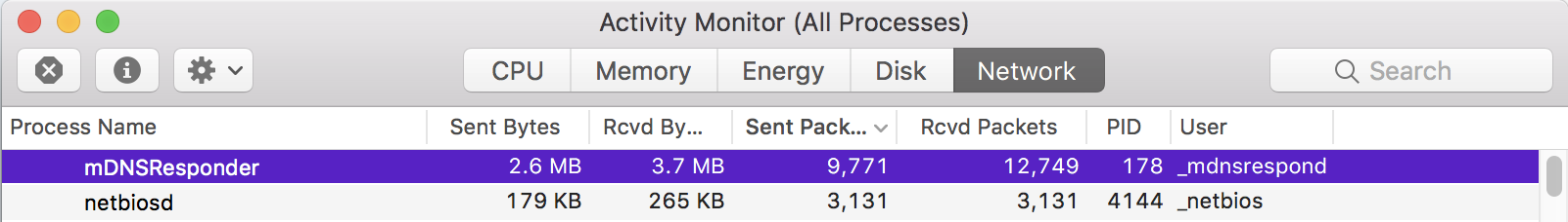

Open Activity Monitor and find the Network tab:
Then find the process I've highlighted above, mDNSResponder, and kill it. (The button shaped like a stop sign with an x in the upper left hand corner)
Does that fix anything?

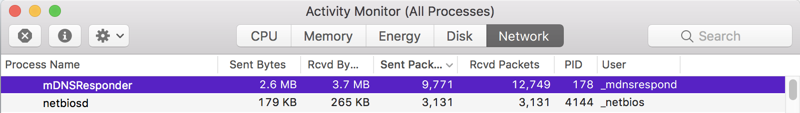

This worked great for me, thank you! And fwiw, I have this problem occasionally with my MBP but not at home, rather when I'm at hotels or other "publicish" wifis. This solved the problem in seconds. Thank you thank you!
