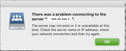

I have an issue with an app that tries many times to connect to the local server of my previous job. Of course it fails and send me multiple error messages.
The app is Papers3 legacy (a library manager). It's not supported anymore by the customer service so I'm all by myself.
When I open it, it would try about 8-10 times to connect to the missing server. I usually receive two error messages at once

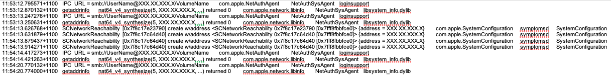

I am 100% sure that it's that app causing the issue. I could correlate them with the console (but I don't remember how). Plus, I only get that error message after I open Papers3 and not at the computer startup or whatsoever.
The server is not in the login items or in the server list anymore.
A search in the console for the IP address doesn't return the Papers3 app but instead processes like SystemConfiguration (com.apple.SystemConfiguration) and NetAuthSysAgent (com.apple.NetAuthAgent, com.apple.network.libinfo).
It looks like some process still have the server in memory that papers tries to connect to.
