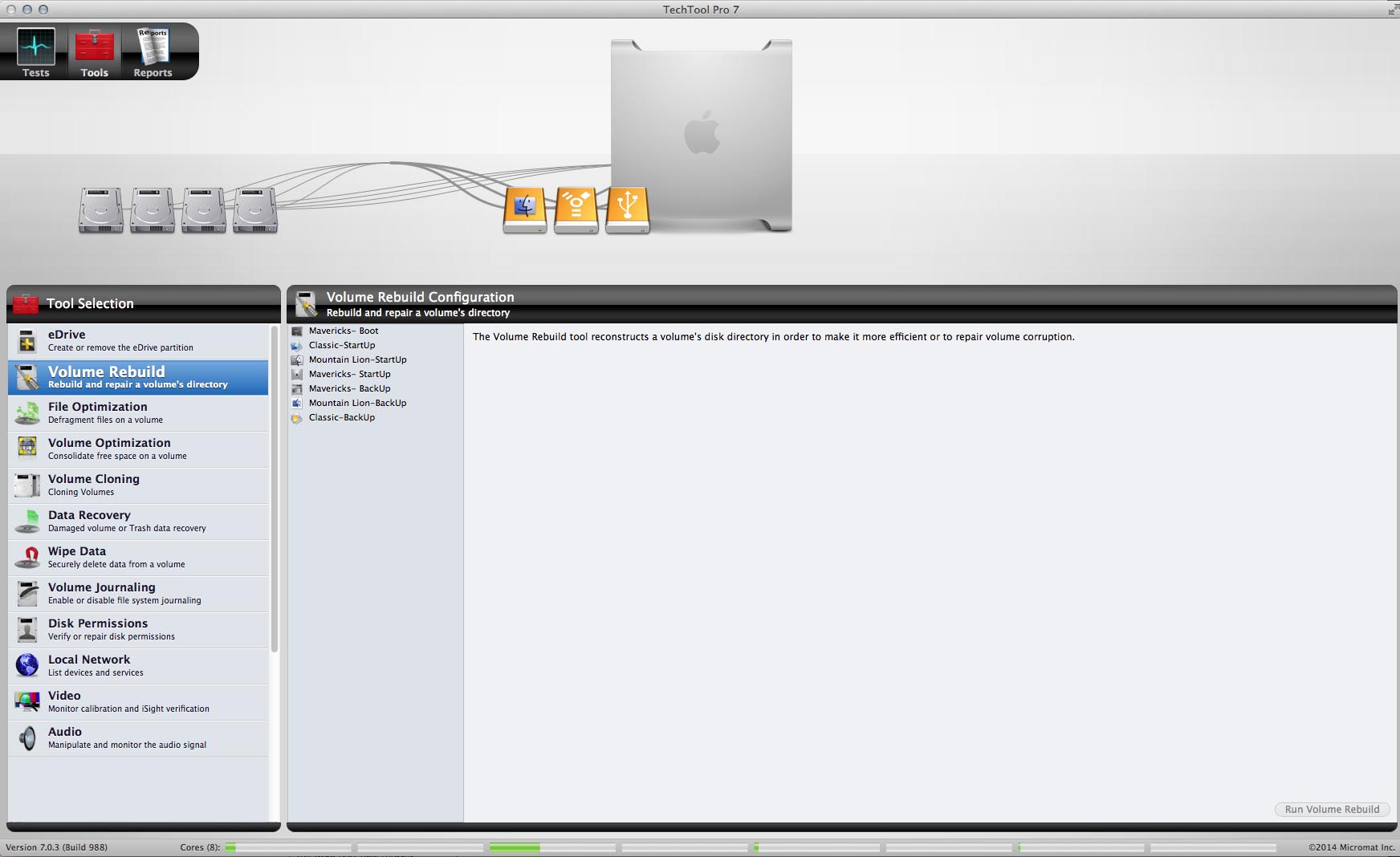

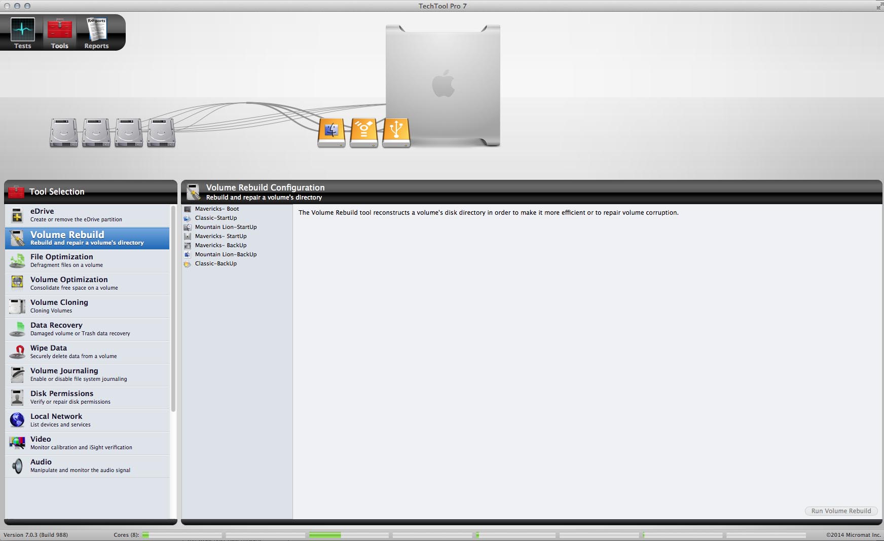

Sorry this happened. Actually TechTool Pro has two Data Recovery options under the Test Icon. Volume Rebuild and Data Recovery. And, I don't know how one corrupt volume would affect the others😕
Lou
TechTool didn't even display the drive in question, so there was nothing to select. It wasn't grayed out, it was GONE BYEBYE to TechTool.
