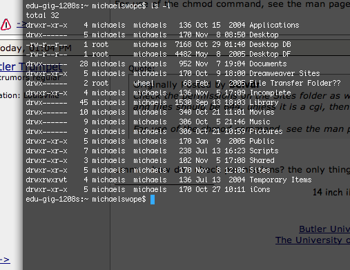

umm... how do i check permissions? the only thing about permissions i know is running disk utility.

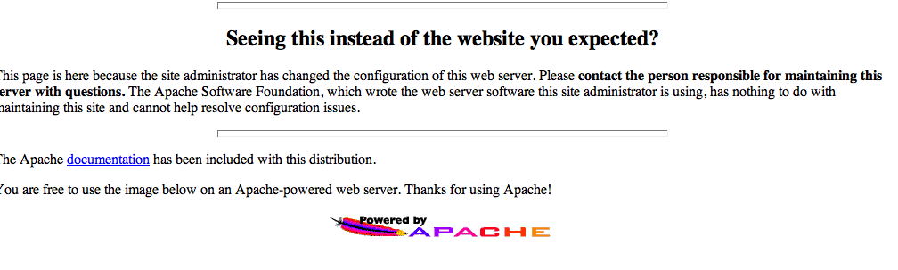

how does this look?
Alternately, you can simply go to your Sites folder in Finder, click on it (the Sites folder), hit ⌘-I to get info, go down to "Ownership & Permissions:", open up Details, make sure everyone except you (the top item) has read permissions, then click "Apply to enclosed items...". You should have read/write permissions, of course. Do this whenever you see problems, as sometimes you drag in items that are not readable to the outside world, and hence not to users accessing them via Apache.

What happens when you type in localhost/~shortname? The reason you get that page when you remove the shortname is that the default location of Web Server is in /Library/Web Server (or Web Server Documents or something), note that that is not ~/Library.
There are some pretty good articles about setting up Apache on your Mac over at macdevcenter.com. I would check them out.

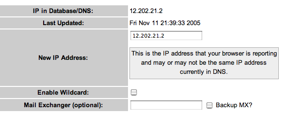

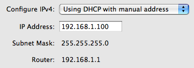

okay, i did everything... look at the images i attached to see if it looks good to you, and maybe you can figure out why its not working.
picture 1 - port forwarding
picture 2 - my IP under status on my router
picture 3 - what dyndns has for my ip
picture 4 - what i have set in system prefs for my ip
im thinking my problem is picture 4, but i cant get my ip to be 12.202.21.2 and still have it connect to the interenet. it will only work with 192.168.1.100
thanks again 🙂
