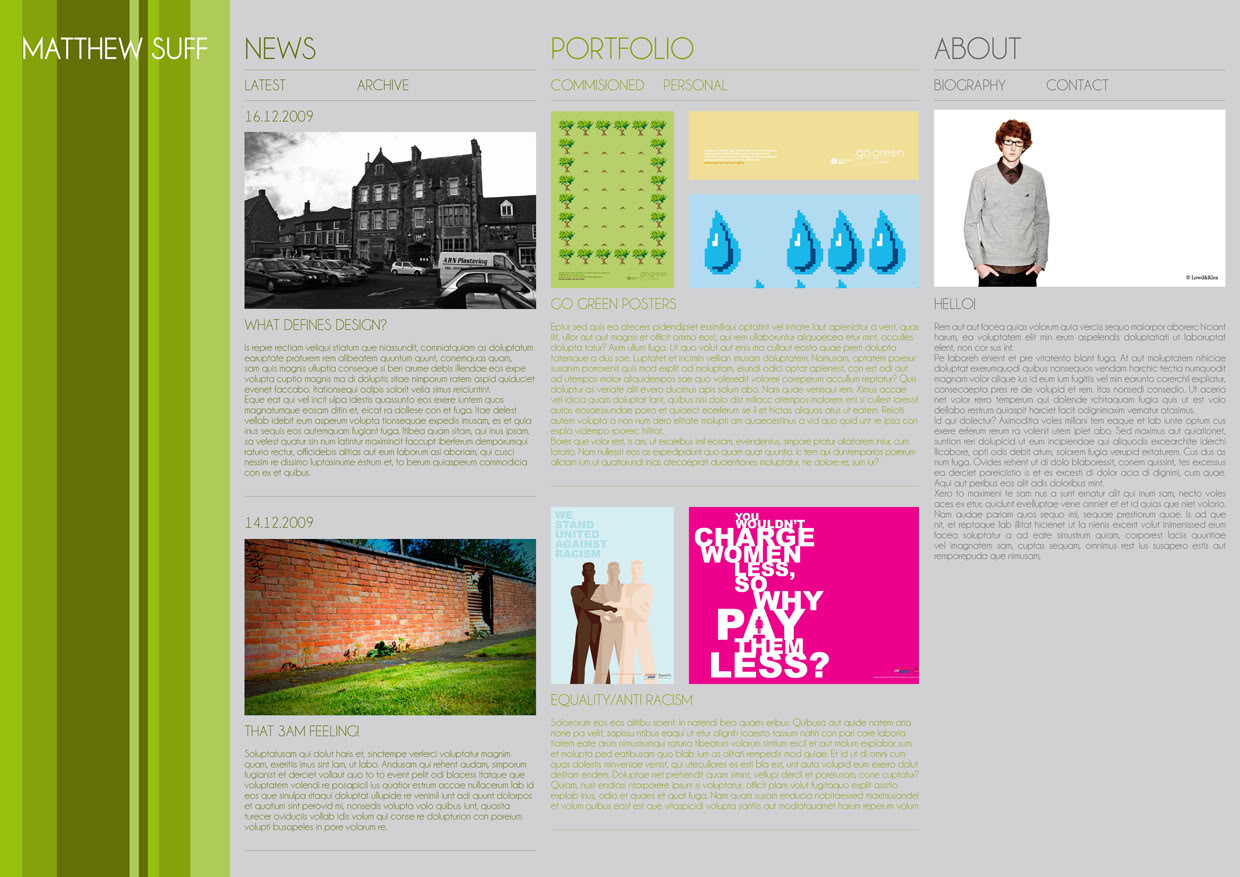

So I finally decided that it was about time for me to create a website.
I need more people to be able to quickly see my work, I am a graphic designer.

It's kinda hard to read - the text and the background need some more contrast between them. And speaking of the text, it's very very small. And there's a lot of it. Are you really planning on using that much text? Shorter is always better.
Next...I think the emphasis needs to be on your portfolio and your work. Right now, the focal point is the content-less green stripes going down the side. Don't waste a focal point like that. Put some contact info or links there. Or, make the green stripes less prominent.
In terms of usability, if you're positioning this site to drive freelance work your way or to hunt for a job, don't bury the contact info behind a link.
I'm in the same boat. I'm a print designer trying to learn some CSS and javascript. And I hate it. I'm also in the process of redesigning my current website.

I have not dabbled in web coding for a while, but I know that years ago, I would have floated transparent frames where you want your different content boxes to go, but I seriously suck at web stuff.
Your concept is surely do-able though, and I like the idea. I also agree about the green stripes. They look good, but TOO good, especially est near hard to read type.
I would also recommend against putting a photo of yourself on your site, especially on your home page. It only lends to a negative stereotype against designers, that we are all....Yeah... You get it. If you must put an image of yourself up, work it into a neat design, or do something awesome to it that further demonstrates your abilities, not just what you look like.
I also think you are going to have a hard time finding a color for your copy that will be easy to read on that shade of grey. Either make it darker or lighter maybe?

.....I need more people to be able to quickly see my work, I am a graphic designer....
As was mentioned above...way TOO MUCH text...especially for a graphic designer.
Unfortunately, the green stripe stuff on the left side looks a lot like something from a template

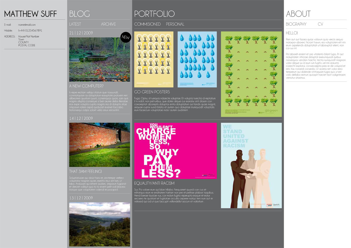

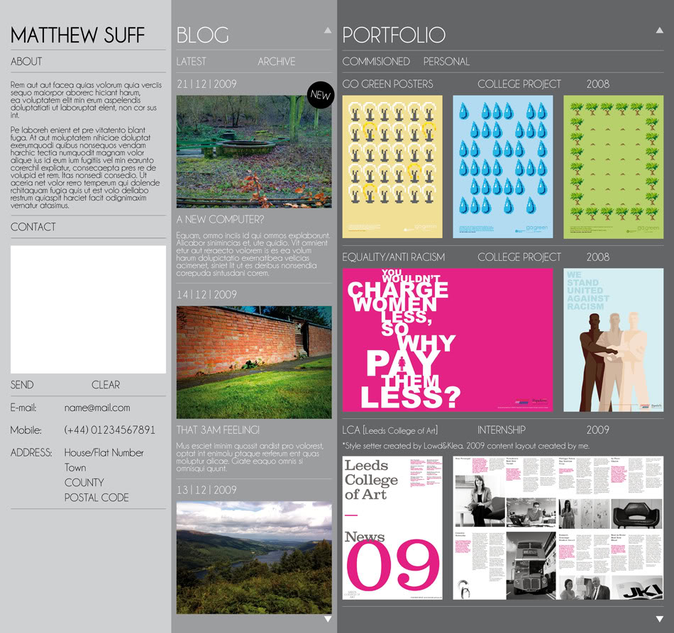

Ok so, here once more is a revised version. I hope you guys don't mind too much that I'm bouncing my designs off of you.
So I've lost one column, and tweaked the Portfolio section.
Panoz7 there are no other pages, the content that is clicked on will load in that column. That's what I would like to achieve anyway.
I think that my main issue at the moment is that the type sizes I'm choosing, as pointed out, are somewhat small. I personally don't like large type.
But the main point of a website is to be universally understood and easily viewed.
Added a contact box, funnily enough I had added this last night but considered it a bit unnecessary. Having said that I don't want people to hit spam filters etc.
Arrows are now present so as to guide the user, would it also be possible to have the user be able to scroll freely? I guess that depends on the site coding.
As for overall sizing I guess I'm in the minority of people with a display 1920x1200 so I have no issue with any website, aside from up/down scrolling. Now at 950 pixels wide.
Thanks as always

Something looks off with the columns in your newest rendition. It feels very fragmented, if you know what I mean?
Panoz is right, too. The type is still very small and fairly hard to read.
Definitive is also right, I completely forgot about looking at this from a web POV. Its probably too wide. I actually try to keep the content of everything I design within 800 px, sometimes up to 1000 pixels, only if I'm feeling gutsy.
Then again, I dont really know web stuff that well, so don't mark my word

When creating my new portfolio website I created it 800x600. It looks good on my macbook and on my 20 inch cinema display.
In my experience 960px is pretty standard for a website design that will be fixed width.
I would suggest using a web-safe font for the body text (such as arial, helvetica, verdana, maybe some form of lucida) to see how your paragraph content will look. I would also increase the line-height to aid in readability.

Content related question; Who is your site aimed at? At first I assumed it was business oriented and you're trying to get work through it. If that's the case, then what's the purpose of having a blog? You don't want to be blogging about personal stuff on a business site and it always looks bad when there's a blog that hasn't been updated for months and months after starting with just a few posts long ago. Is having a blog really a good idea for your site?
800x600 is an old standard. Most monitors have resolutions much greater than that nowadays. 800x600 actually looks bad unless you build in the ability to scale the content.

Is this website used for getting a job or freelance? If so I agree with others you should take out your blog.
How are you going to code it? Flash(highly not recommended) or css/ JavaScript to get the scrolling effect you wanted?

I general when I design a website I design it for a 15" or 17" laptop as most people use laptops. The size you design should not for a computer screen those size regardless of what you have. 950 pixels is good.
If your english or where you live, commissioned could or could not be misspelled.
If your a recent college or university student, then put in a few projects, but most professionals want to see how you think and execute your ideas, Actual real projects would be better then class work. I know this is hard especially if your just starting out in the profession.
Last design was the best so far mate. it is the hardest to design your own web site. I am working on my 5th or 6th site for me...always trying to make it better.
You shouldnt design website body text with fonts like that unless its flash. Stick to default fonts like Arial or whatever so you know what its actually going to look like. Youll have to make the whole site nothing but images if you want to use a unique font, which will look really amateurish.

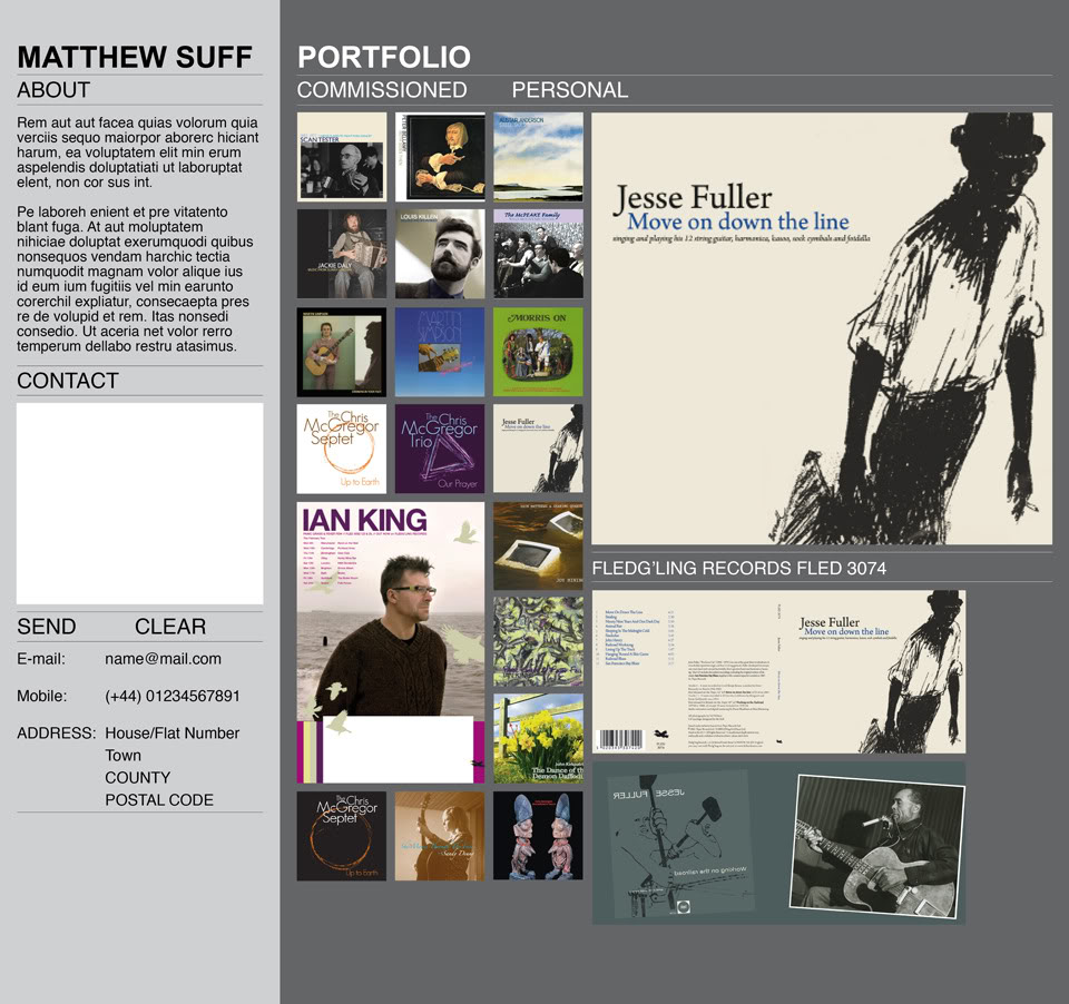

It will be the basis for me to be able to show off my work quickly and easily, with the prospect of getting more freelance work, so the blog is gone.
As for coding I guess I will be doing it the CSS way, but I will have to learn all the coding etc.

I've also taken on board about the text, once more, and have substituted it with Helvetica at the moment. Am I right in thinking that if I want it to be seen as is it needs to be the equivalent of a picture. I think this is definitely an area of computing/design that I don't know enough of.
I am not 100% sure about the two colours behind each column now.
Maybe just a flat colour. I'm gonna sleep on that.

Windows doesnt come with Helvetica, you can use it for titles as images but not for body text. Besides, Helvetica looks jacked up when its small on monitors being rendered by the OS, Arial is a much better screen font for body text. Large Helvetica titles and small Arial text matches fine.
consider removing your home address from the site. wouldn't want some spam bot signing you up for stuff, or some unexpected visitor at your door.
since its a portfolio site, the titles of things probably won't be changing a lot, i assume? then yes, saving the titles text as an image is fine. you whatever font for that you'd like.
its more when you have a blog site or updating news frequently that would require new titles is a pain to just have text as images. thats why i posted the link to other font replacement methods. some of which are a bit advanced though.
for now, stick with images for your titles, and arial as your body text, since its pretty close to helvetica.
