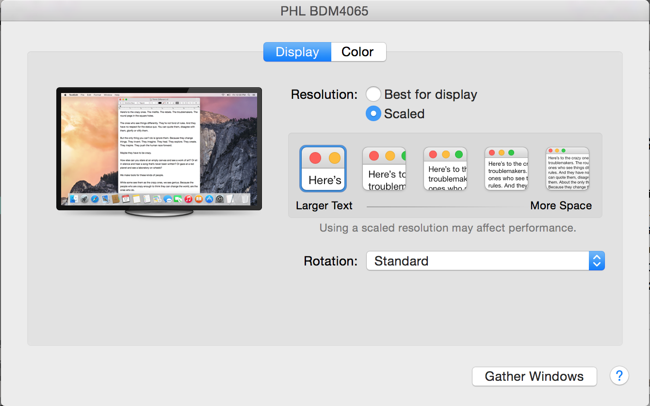

I'm using a Macbook Pro Retina, 15-inch, late 2013 model with the Philips BDM4065UC and really loving the resolution, colours, and Realestate. I currently have only tried using the basic HDMI option but am experiencing a sluggish and unacceptable amount of Mouse Lag! ahhh help!!!!. The only way I've managed to avoid the Lag so far is by going in to System Preferences/Displays and changing the Philips BDM4065UC Display settings to "Scaled" and selecting the "Larger Text" option... the issue here being that I don't really want to work with this setting as everything becomes too big/zoomed in and I feel like after forking out $1K I shouldn't have to succumb to this being my only option...
Any advice/insight appreciated 🙂
