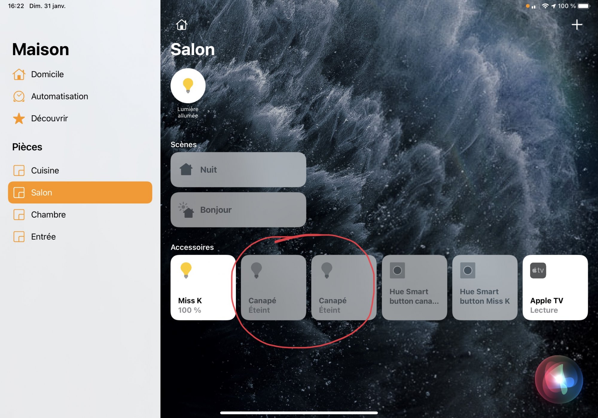

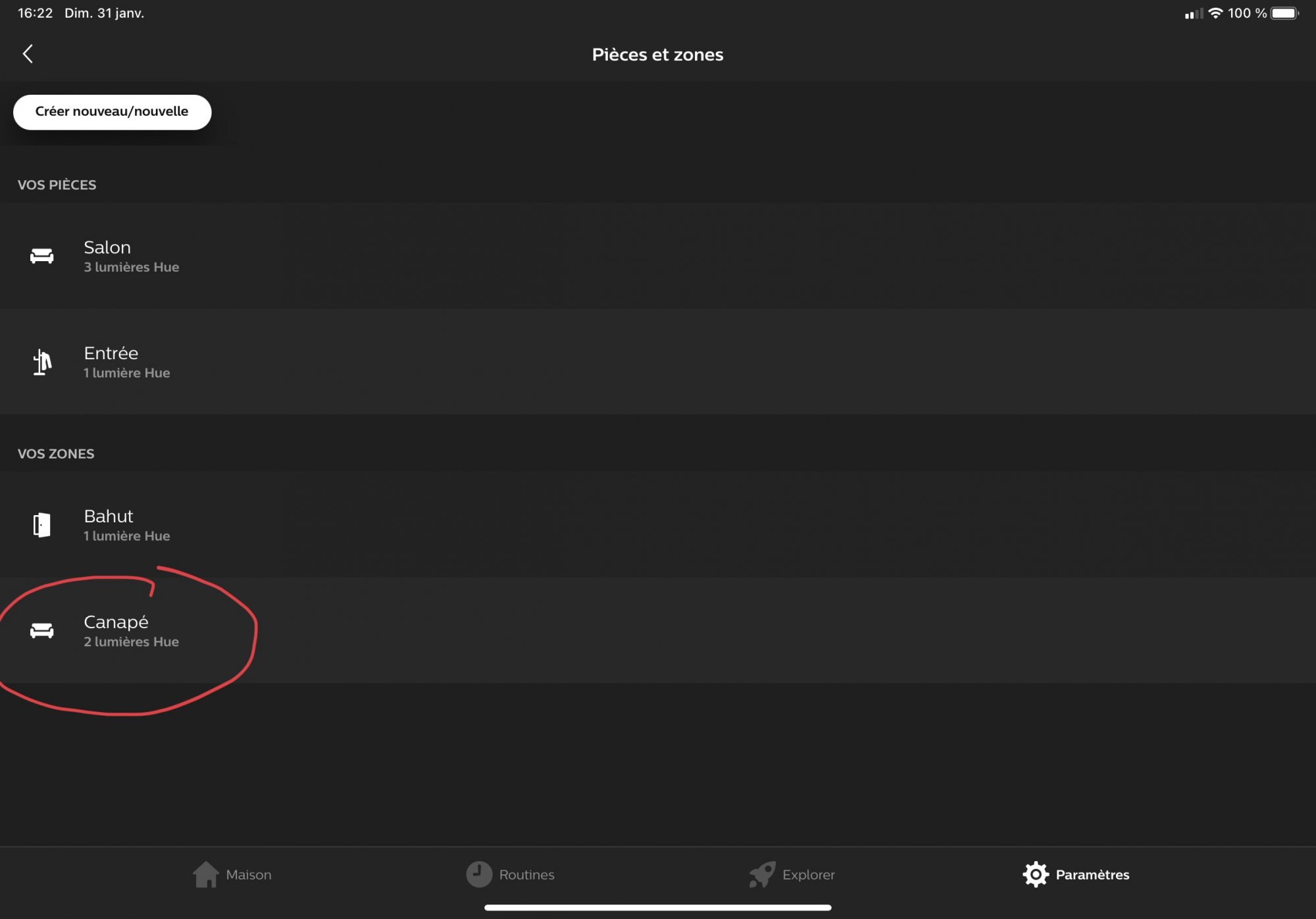

Hi guys, I am also a rookie with Hue. Bought a few E27, smart buttons and a HomePod Mini. I have a question please. I have a light in my living room with 2 bulbs. Is there a way to merge them to one light so it show as one light and not 2 espcially in Home Kit where I need to turn on both.
See pictures. It is in French so FYI : Salon = living room, Canapé = couch (as my light is above my couch).
Voila!
Voila!

Yes, tap and hold one of the lights and select the cog wheel icon and go into the settings. Select group with another accessories... and place them both together and give it a name like "lamp 1" or "lamp 2" etc. Works great.
Ok on what app? Home kit or the Hue app?
I’ve never been able to add my Hue Bridge to HomeKit, despite the fact that they’re compatible. I think it’s a hardware issue with the bridge itself. So, I rely on the Hue app as well as Hue Essentials, which adds some nice functionality to the platform (including the watch).

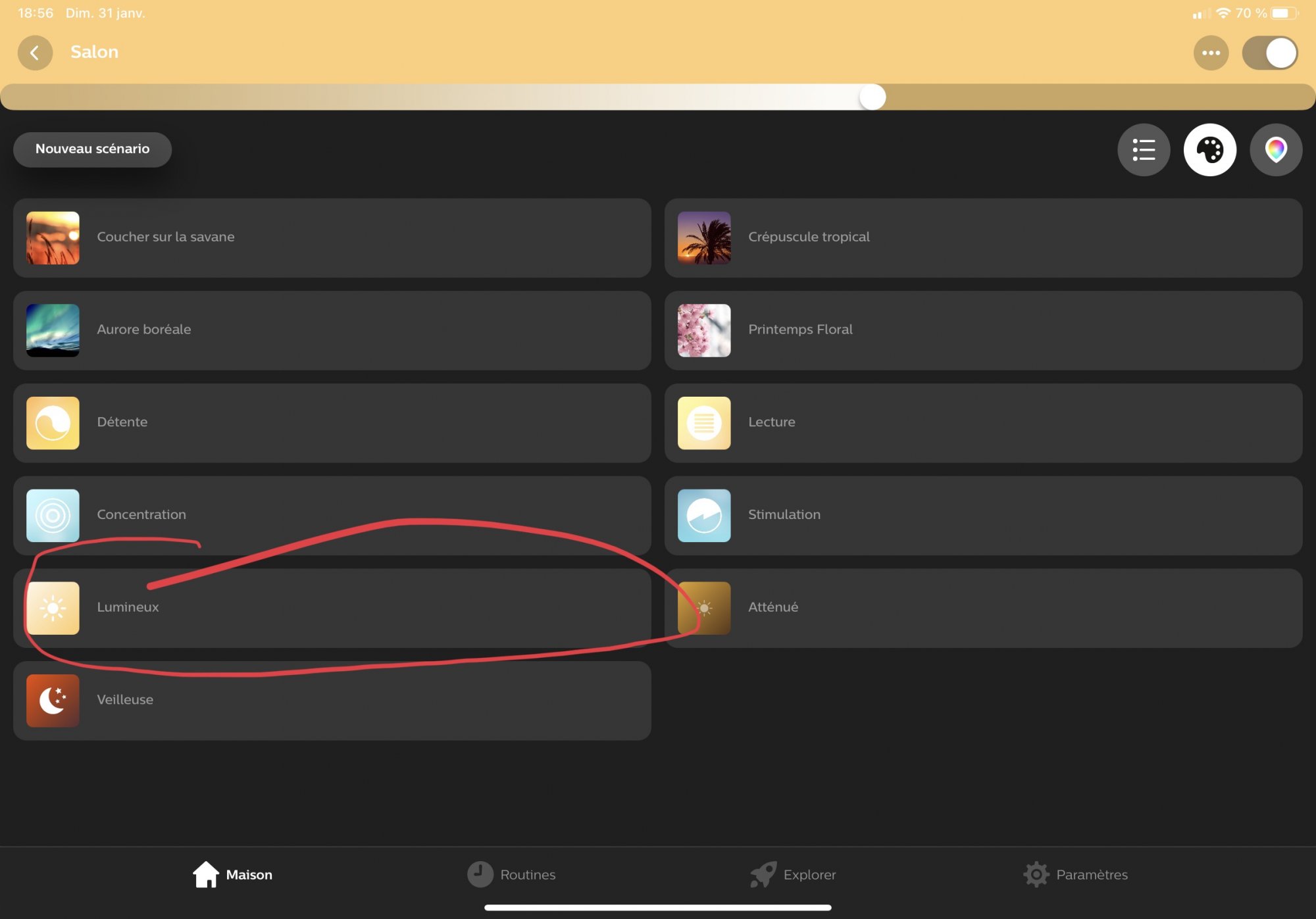

Thanks. It worked perfectly well. As it seems you are a Hue Guru I would have another question. I like to have by default the “lightfull” scenario in my living room made of 2 lights (one single light bulb and the other one with two light bulbs). If I decide to dim the lights or choose another color how can I ask Siri to come back to my preferred scenario? So far it does not work or I do not know how to ask him simply to come back to my “preferred scenario”. Can i do that? If not in the Hue app maybe in the home kit app? Maybe I am not very clear.
Let me know
Let me know

When u tap that Hue Scene do you see a pencil icon in the top right corner? If so tap that and a menu comes up and one of the options are to add to Siri Shortcuts. See if that does what you are describing?
That is right but if I want to add to Siri that same scenario it tells me it is already used. So If I use scenario 1 and want to link it to room A it is fine. If I want to use that same scenario for room be it tells me it is already used and I cannot add it.
Try opening the Home app and select the + to add a new Scene (give it a slightly different name) then select the accessories (lights) that you would like but are different from the other scene and that should work. (I think)
