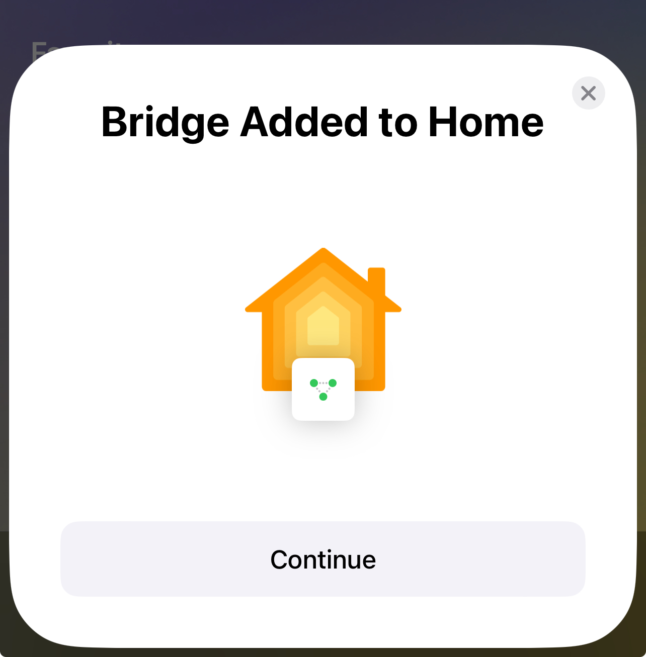

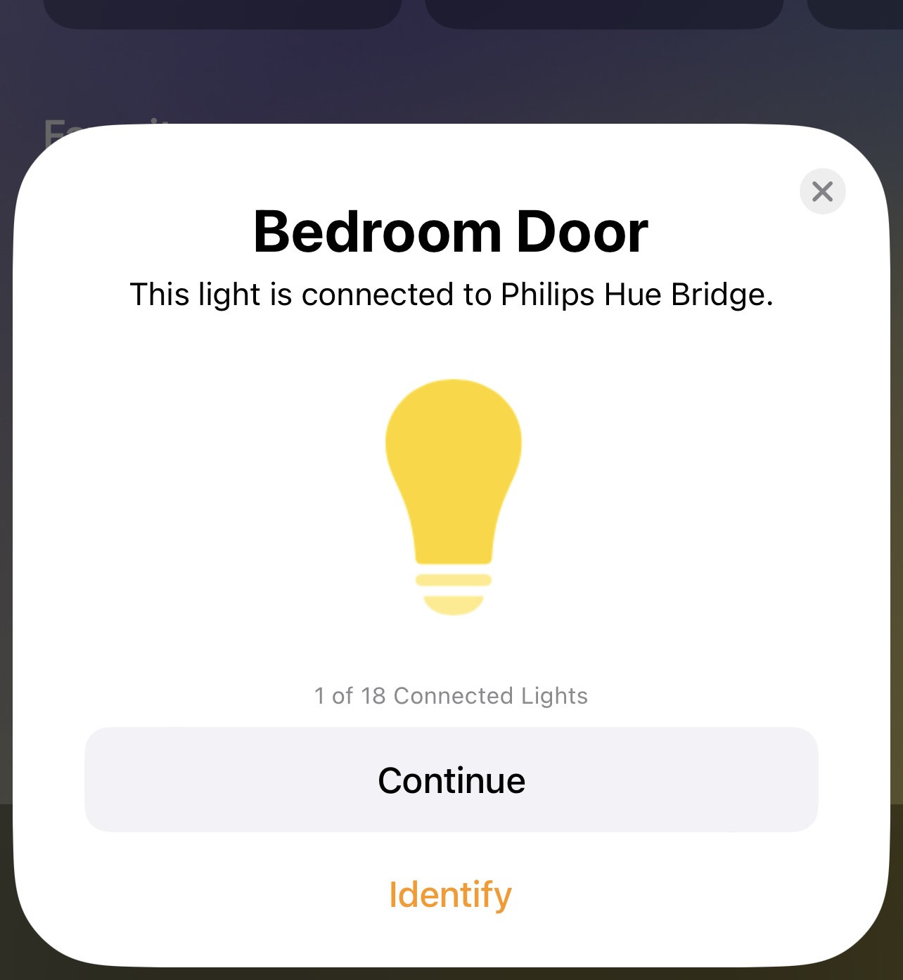

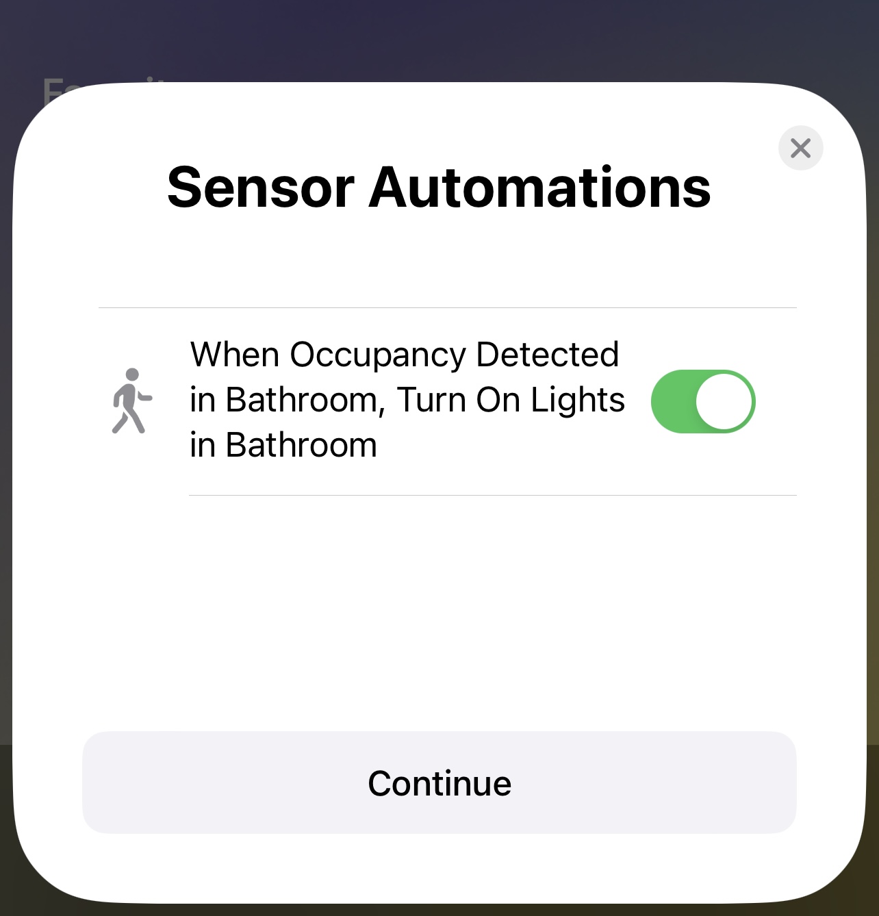

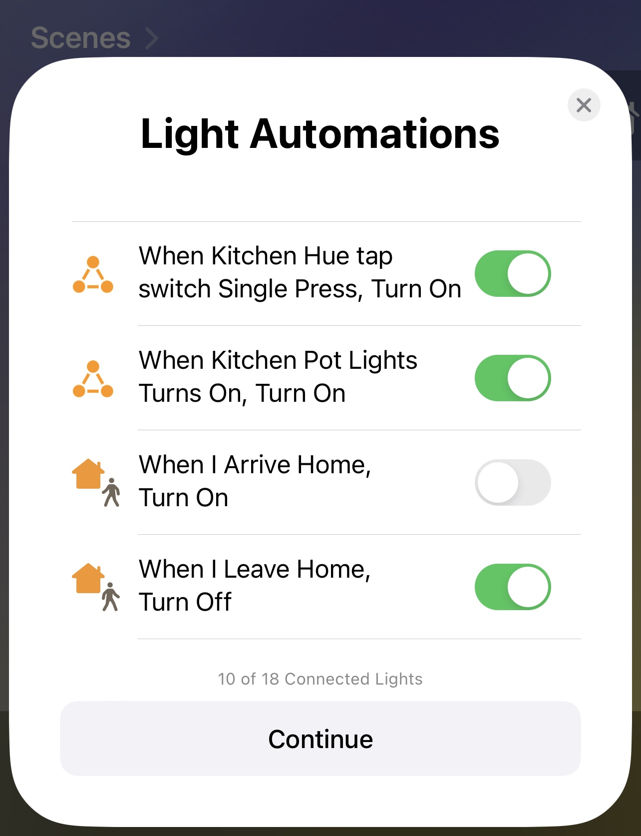

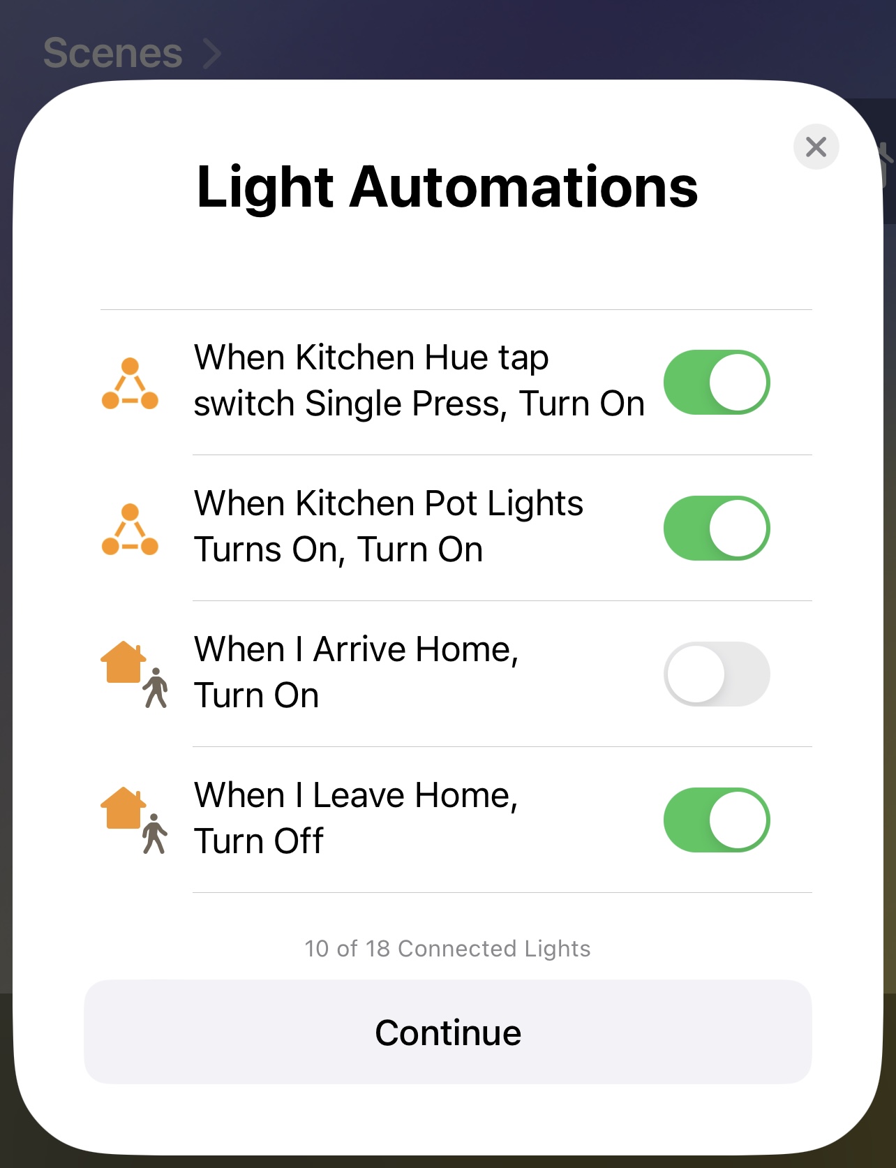

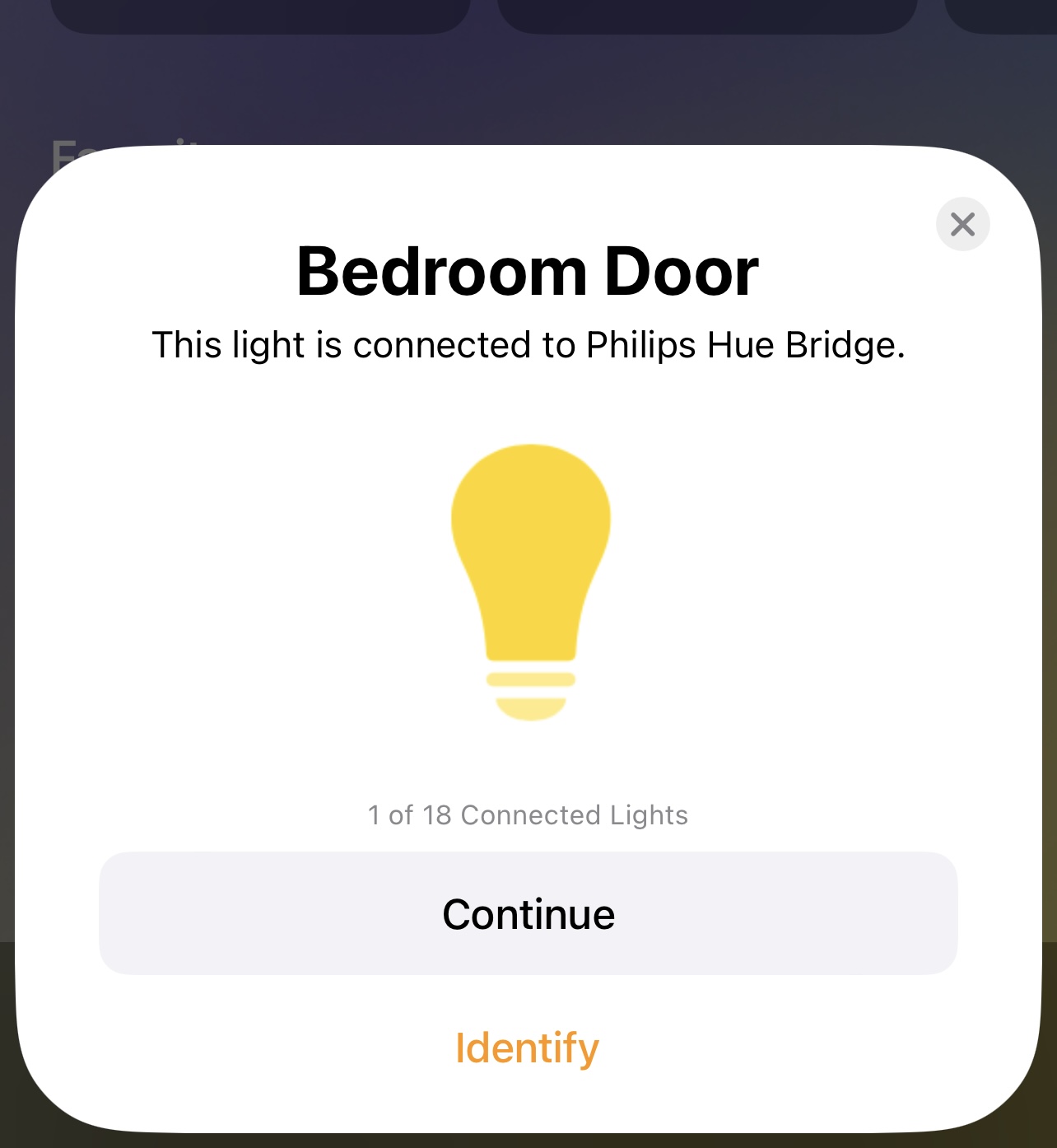

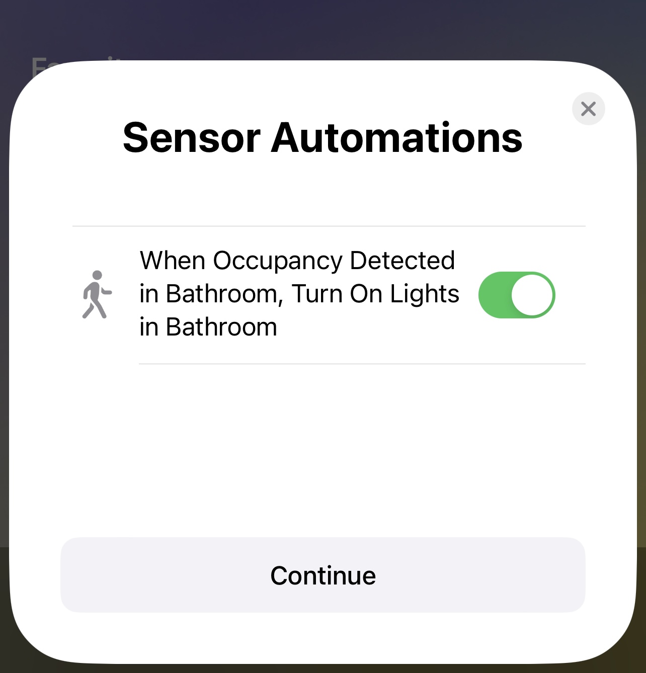

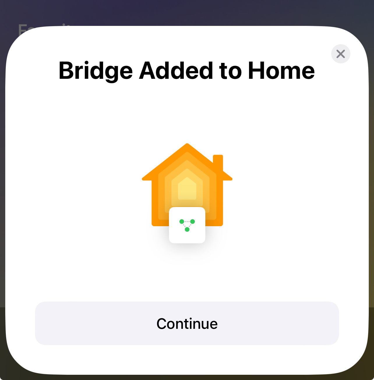

I just set it up and wanted to add my perspective as the general sense in this thread is that it messes things up. Not for me.
It was great!
After adding the bridge to the Home app, it went through all of my lights in an easy to understand flow, with an Identify button so I knew which one it was asking about, and asked to confirm the room, the light’s name and reviewed the automations that were setup.
View attachment 2270514View attachment 2270516
This enabled me to harmonize the names of my hue lights which Hue never updated when I changed them in the Home app over the past few years. I’ve been meaning to do this for a long time and the Home app walk through made it painless.
It also found my Hue Taps, Dials and sensors and added them all into the Home app. I no longer need the Hue app at all.
I have about 25 Hue lights and accessories and this took me under 10 minutes to walk around and confirm. Would’ve been ever faster if I trusted Hue to have updated changes I made in the Home app which it didn’t. In the end, I have a much cleaner setup that I can oversee entirely in the Home app. So glad I went ahead and did this.
So Automations where kept intact? That´s my biggest concern with switching to Matter

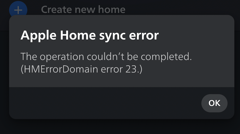

It is insane. buried in menus, couldn't find it. then went to siri integration, and clicked on it and then clicked on a small menu item on the unlink button.
I have 50+ lights and accessories. the light names disappeared and each of them i had to add one by one. every light you have to choose the room, automations etc. at least 3 presses and multiple scrolls.
and i don't even know which light is which. many of them named like hue bar 10 11 etc. all the names i have renamed disappeared and reset to default

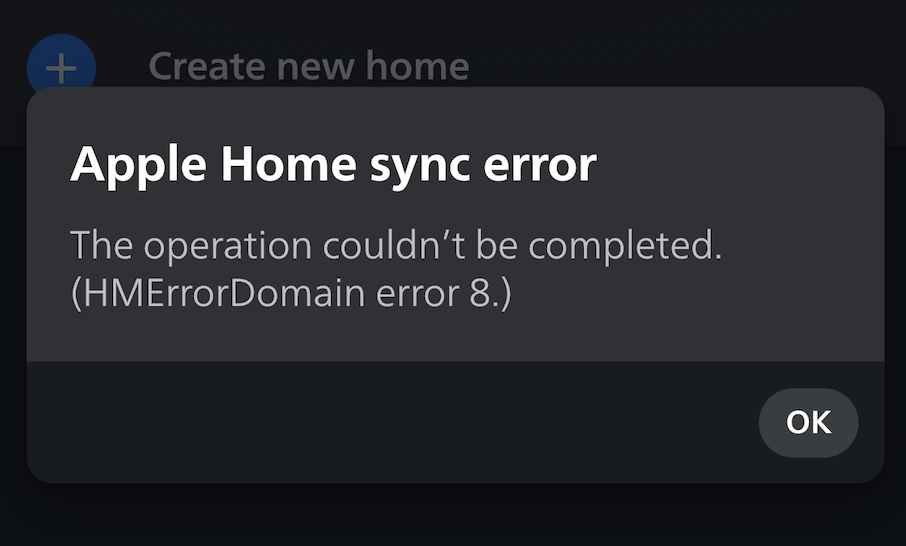

after i did all of them and the switches and buttons and what not this came while i was adding lights:
Then some other errors when i retried. I didn't cancel it but it throw an error saying i canceled it.
I think what they rolled out is far from being mature. i don't advise anyone to do matter upgrade before these guys fix their software.
