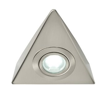

I'm smitten with my Hue kit and HomeKit toys just now. We are in the middle of a rebuild and i need some help regarding our kitchen cabinets. We want 3 downlighters under cabinets in the kitchen. You know, this type...
Or the triangular version...
Problem is that I have 3 Hue GU10 bulbs and they are obviously too big for these low profile fittings.

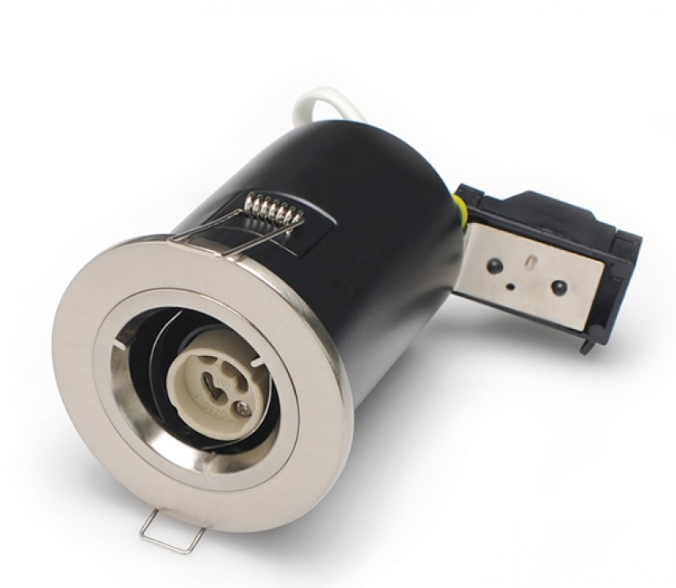

Is the answer to have them recessed inside the cabinets or are deeper under cabinet fittings available to fit the Hue GU10's? Ive tried looking to no avail. My current solution is to simply recess them using ceiling downlighter fittings like the one below then box in the fitting inside the unit?

Personally I would avoid putting the gu10's through the base like your describing. The housing will be prone to knocks and potential spills. Given gu10 are mains powered the risk is higher. As a side note depending on where you live running mains lighting in the manor your dis robing would be against code especially if it passes near a sink or stove.

Didn't figure that having them in the cabinet might not get them signed off on 17th Edition here in UK. Not that it matters, but no liquids in those cupboards or in 'splash zone' but that wont matter.
If they are boxed in and cabling behind carcass, that may pass. Seen it done before. Either that or the bulbs are going back much to my dismay.
See I was thinking you were American 110v if your over here in the uk your golden! We're allowed to do what your after. Boxed in would be good from a safety aspect.
