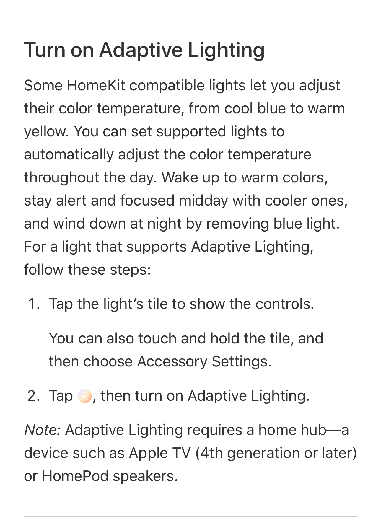

A HomeKit specific feature where if you have a smart light that supports changing color temperature (i.e. warm white, cool white, soft white, etc…) and the manufacturer supports it (Philips Hue and Nanoleaf are two I know of without researching), then depending on the time of day, the light bulb will change color temperature automagically. So in the morning when you’re getting ready for work, it will be a cool energizing white. During the day, it will be more of a natural sunlight and at night, a warmer white for relaxation.

From Apple’s support page:
