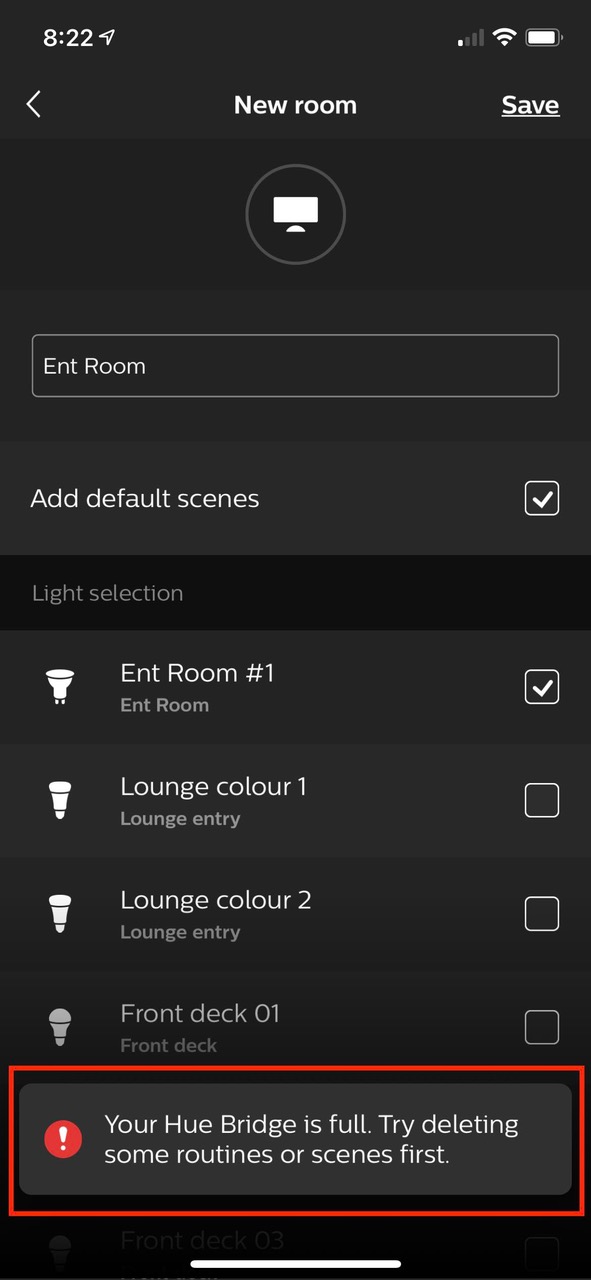

Well... I've been using Hue for a few years now & will throw my hat into the ring on this topic...
We have a Bridge (Gen2) and around 20 globes and few remote dimmer switches.
Up until recently I totally loved it.
What I have always found frustrating is that you can't just name & control a single globe. You have to group it into a 'Room' or 'Zone' even if that means there's only one globe in that group.
Anyhews... we're renovating & I had big plans for extending our Hue gear including a new TV room totally lit with Hue globes.
I go to add a new 'Room' and get the alert in the screen shot. WTAF?!?!
Most of the 'Scenes' I have installed are their standard ones, I had this alert once before & had to remove all my 'colour recipes' based on advice from their support people so that removes a cool Hue feature - being able to blend your own colours - and I only have one routine set.
I have around 12 'Rooms' and 2 'Zones'.
Philips claim that you can load 50 globes into one Bridge but how does that work???
Each globe has to be allocated to a Room or Zone to be usable and if there is such a low ceiling on the number of Rooms & Zones it's pretty fraking useless isn't it?
Short version... Philips promote Hue as a 'whole of house', indoor & out, lighting automation system but I fail to see how they can claim that when you simply cannot achieve that due to apparent capacity limitations of the Bridge.
Get a second bridge… I was running three at one point when I was using Hue. BTW, you’ll need to create another account and you won’t have remote access on the second bridge. However, if you’re using HomeKit, it will all get stitched together in there.
@rexone I think there must be more things filling up your Hue bridge than you realise.....20 bulbs in 12 rooms is defo NOT a problems for there Gen2 bridges........so can you clarify some info for us here:
How many remote dimmer switches do you actually have?
Do you have any motion sensors?
How many of your own scenes/colours have you created for your 12 rooms?
The reason I ask is because each dimmer switch takes up quite a bit of memory if you have them configured with the Hue app......I discovered that some of the switches would be easy enough to configure through the HomeKit App instead of the Philips Hue app.....just to save some memory space on the Hue bridge.

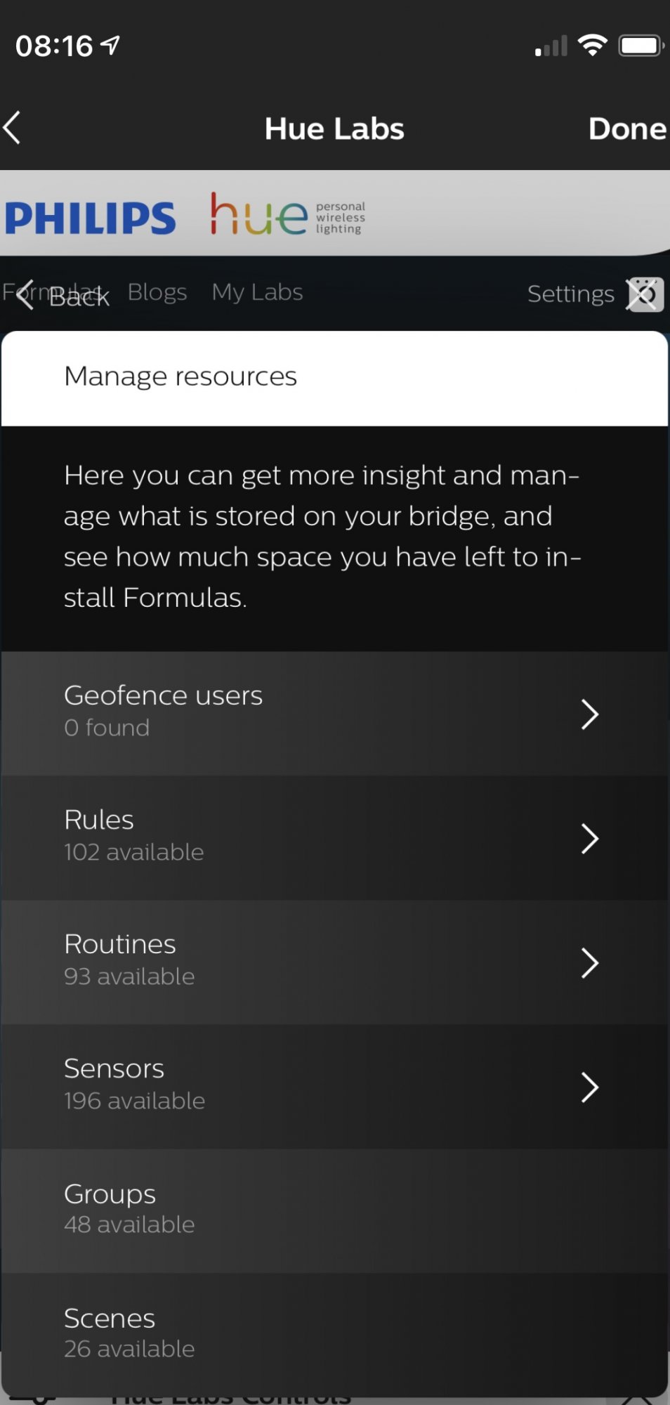

And for reference I currently have (according to the Hue App):
51 bulbs
9 dimmer switches (I think I have all these configured in the HomeKit App)
6 motion sensors
14 rooms
2 zones
All connected to 1 hue bridge.....I have not counted how many scenes I have created in the Hue app...but it won't be more than 15 tops.
What does your bridge show when you goto the manage resources screen?
Here is mine:
