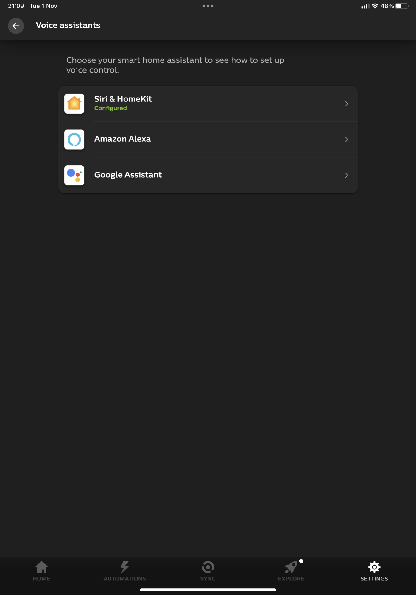

I think Siri & HomeKit integration is off by default. Did you remember to go into Hue app settings > Voice assistants and reconfigure Siri & HomeKit?
Yes, I checked all that but I’ve just found what the issue was. The problem is me lol
