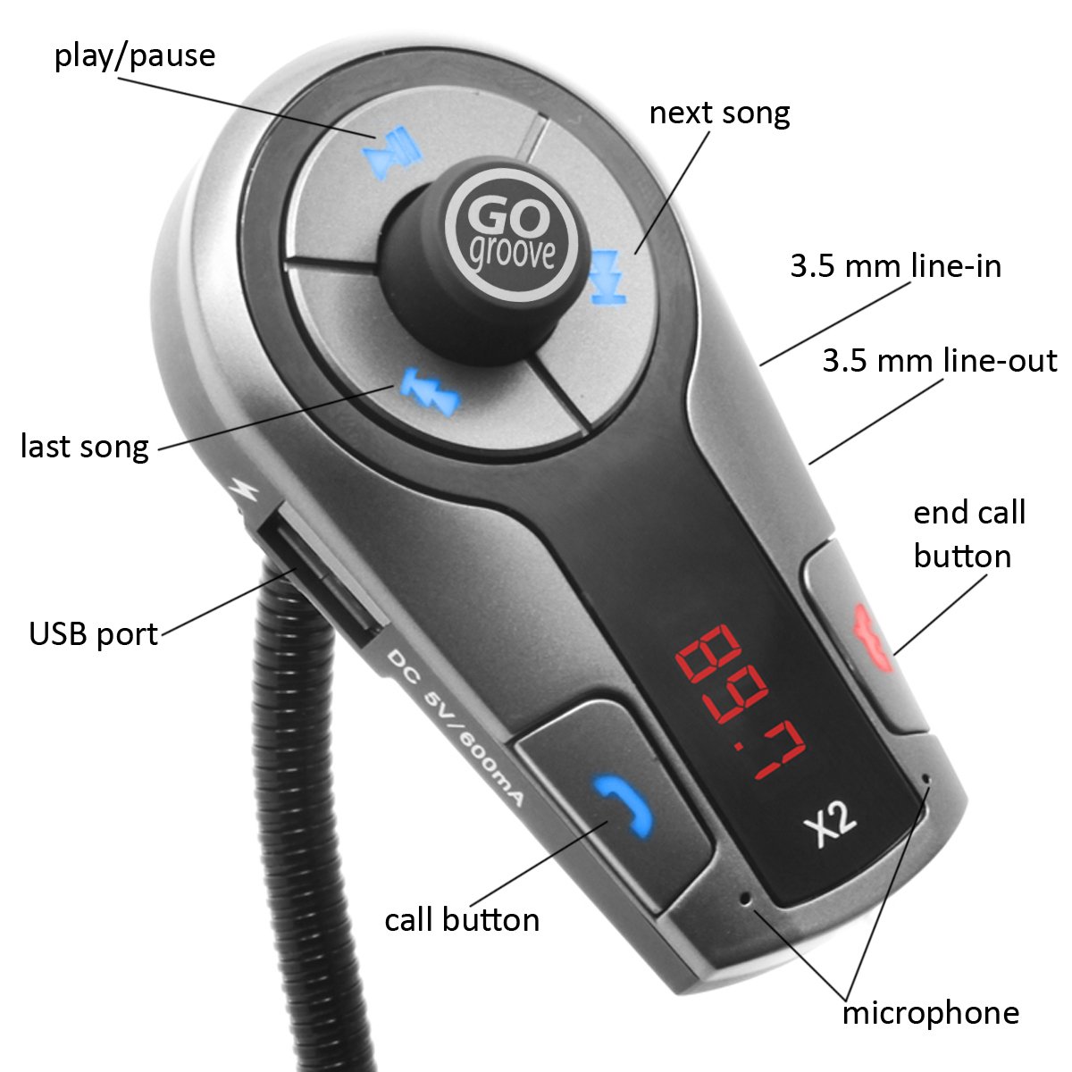

Get one of these:
http://www.amazon.com/FlexSMART-Transmitter-Hands-Free-Blackberry-Smartphones/dp/B003PPGOC0
Connects to your phone with Bluetooth and transmit either over Aux or FM. You can stream your music (controlled on your phone) and switches to hands-free when you get a call. It also has a USB port to charge your phone. I've been using this particular model for several months with no issue.

The device I linked to, and others like it, will route whatever you play to your car's aux port. Either I don't understand what you mean or you don't understand the device.

As far as I can tell that device doesn't have an aux "out". It has an aux "in" according to the amazon.com page.
BrianBaughn,
Thanks for the clarification-i didnt study the device close enough; that's a great solution ! i also see they make one without blue tooth ($30 less) but i like the Bluetooth version 🙂 -one less wire to phone.
