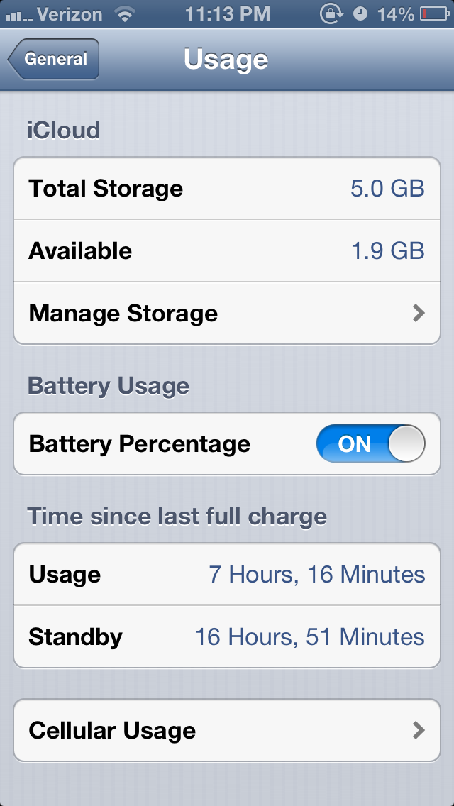

My Verizon iPhone 5 was doing this too. It would shut down in the 15-30% range. I would plug it in and it would be at the same percentage. Apple replaced the battery in the store for free, the phone was still under the 1 year warranty. Took it home and it never activated. Took it back to the apple store again the next day and they replaced the phone. It has iOS 6 and I'm leaving it there. Got 7+ hours of usage yesterday with 14% battery left. I really think it's iOS 7 doing this to the battery percentages.
