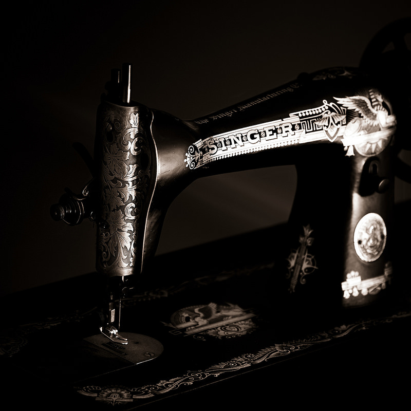

I was intending to take this for Ken's Retro-themed competition last week but didn't get round to it. Despite being from around 1910 or so, these are not particularly rare and were made by the million, this one in Glasgow. Comments always appreciated.
Retro sewing machine
by another scotsman, on Flickr
I can remember my mother using something not much newer than this.
