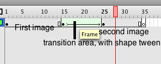

You can do it in an easier way - except things can't be automatically changed. Put a picture on each keyframe, then click break apart, then create a keyframe for the start and finish of the transition, with the same image as the "still" then right click and do create tween.
Sorry if this is a bit hard to understand, let me know if you want me to email you a sample file or whatever.
