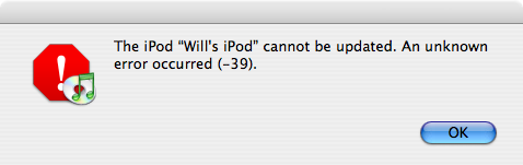

well, it's still not working. Different problems this time. new symptoms:
no system freezing, it will delete photos quite happily (I tried doing only a few albums), and repeatedly gets this error (-39)
(see attachment)
I don't know what to do... I'm out of storage space, but I have stuff on my ipod O don't want to nuke...

I've found an old drive, so i'm taking off all the stuff I want...
I'm going to wipe w/ disk utility then restore with ipod utility
Good idea. If a standard erase doesn't work then try writing zeroes to it (in Disk Utility). It's one of the security options and it's a more heavy duty way of erasing a disk. 🙂
