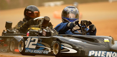

this was taken at 200mm

the guy that i used to work for took that one with a nikon d200 and a 70/200 f/2.8 lens
i have been trying to get a hold of him so he can send me the pictures that i took so i can send you more
Thanks, I would love to see more of the gokart racing photos. I love shooting the races but just cant get a great shot like the one you posted. Maybe with the new set up I buy I will be able to...rose
