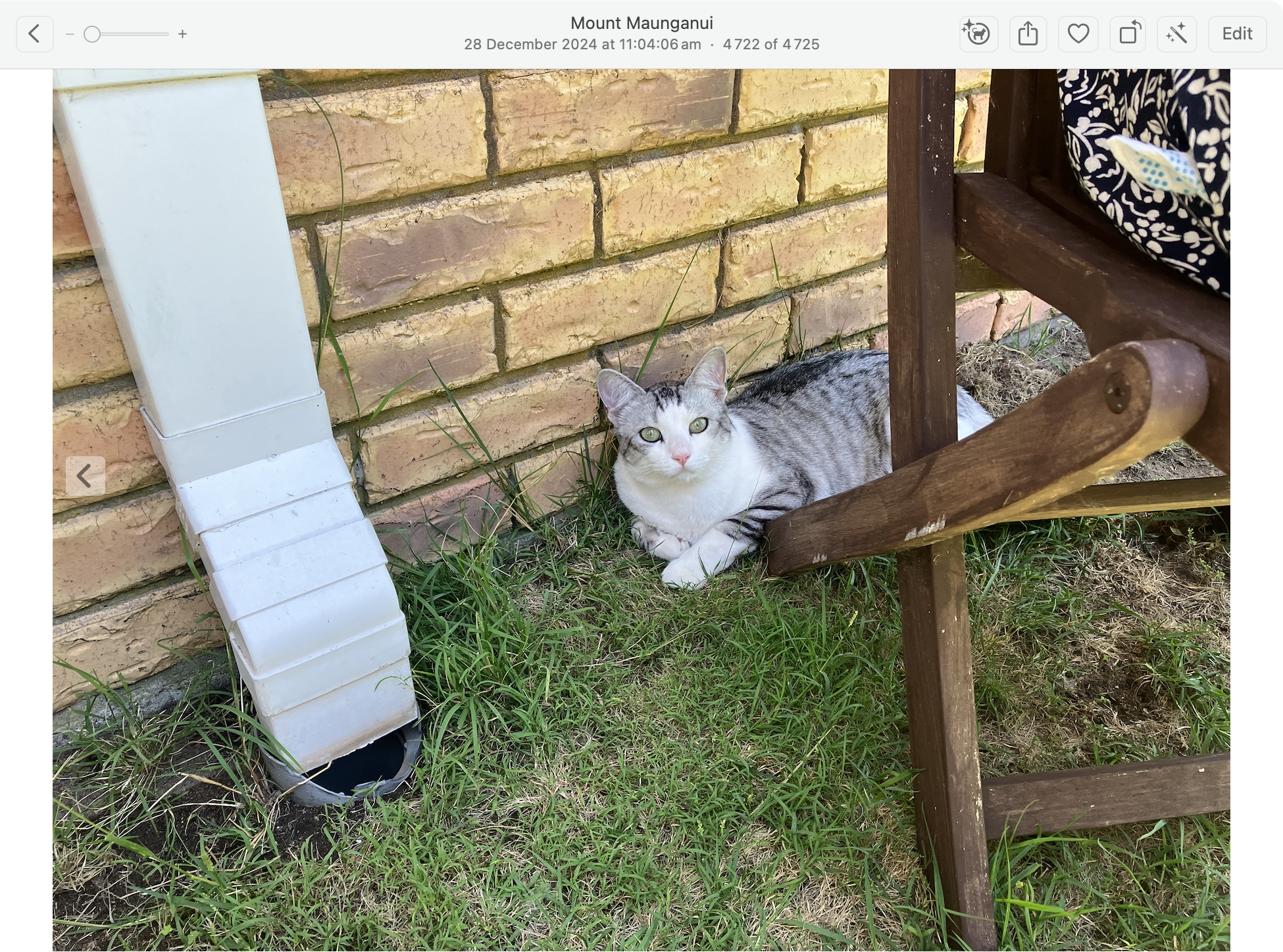

In the Mac Photos app, e.g.
This one definitely wasn't taken at 11:04 because it's at my brother's place and I didn't get there until the afternoon.
mdls reports the same dates as Photos (albeit in UTC instead of NZDT):
Code:
kMDItemContentCreationDate     = 2024-12-27 10:04:06 pm +0000
kMDItemContentModificationDate = 2024-12-27 10:04:06 pm +0000
kMDItemDateAdded               = (null)
kMDItemFSName                  = "9A8192C0-1589-4DA8-B98C-378607CDE31C.jpeg"
kMDItemUsedDates               = (null)
