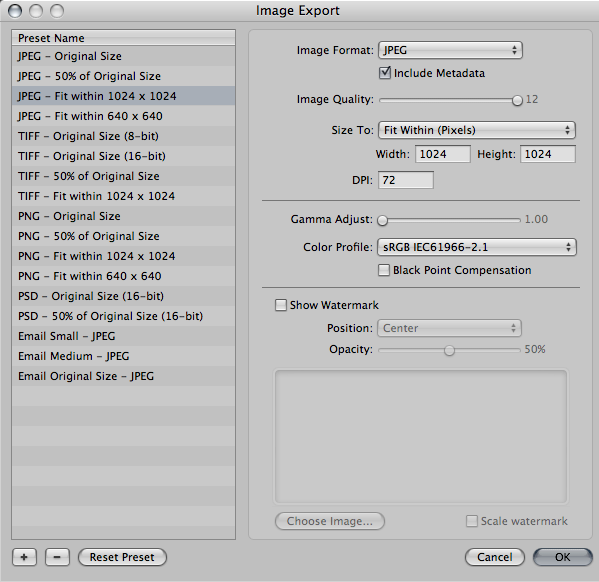

Bellow are the settings I use to export from Aperture with my images, and the settings that are coming in from my Canon 60d.
Please let me know if I am doing something wrong.

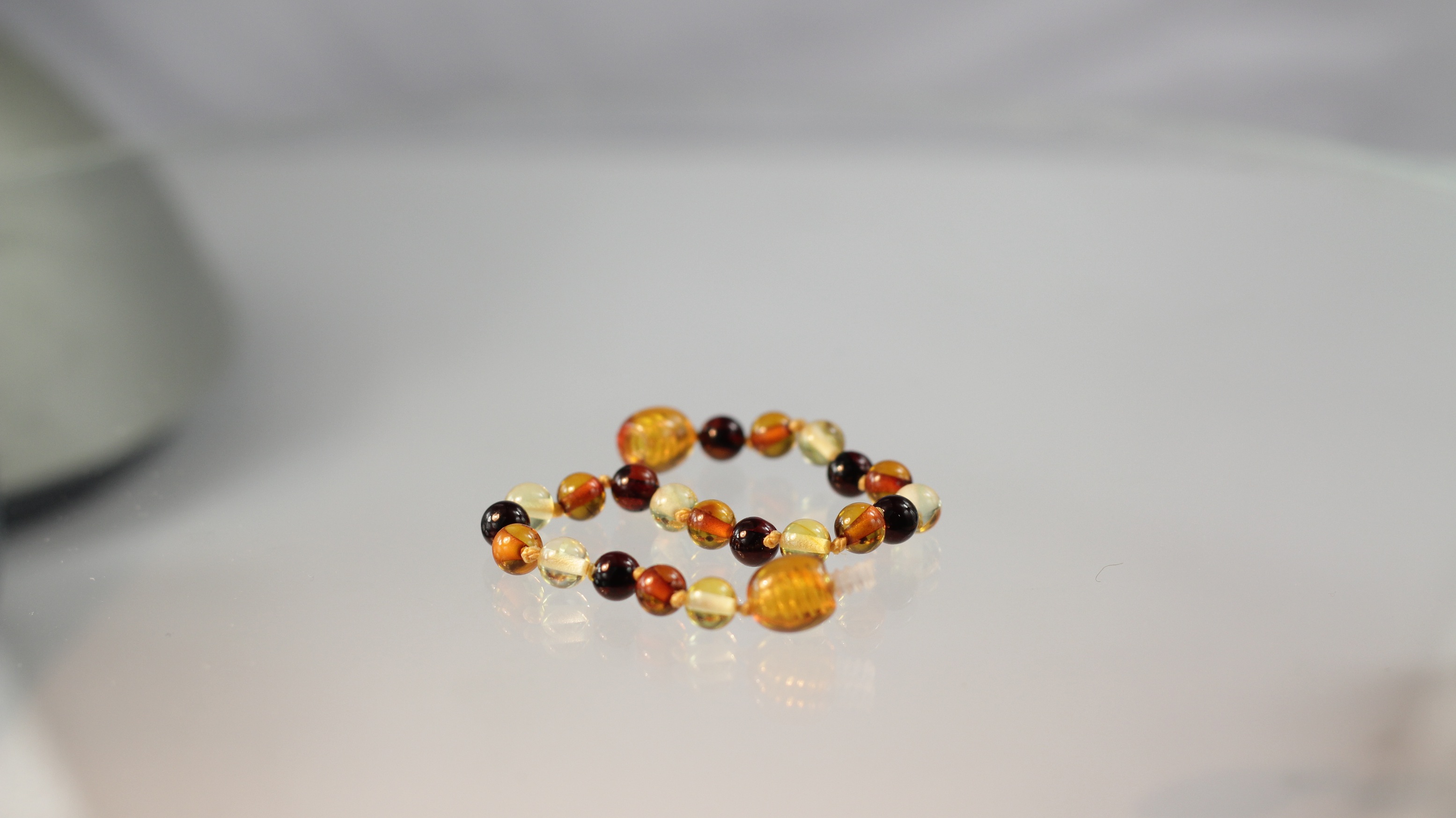

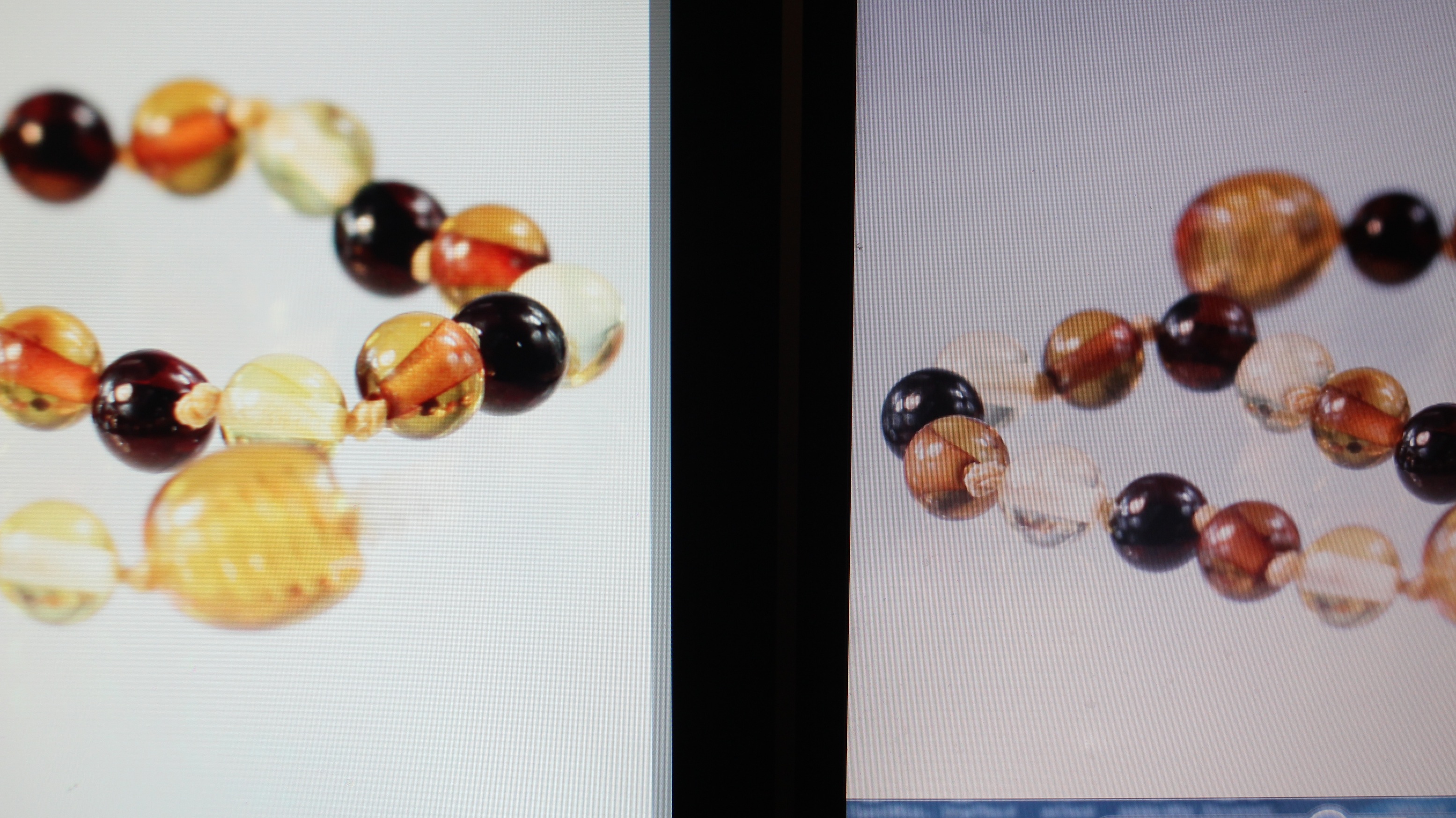

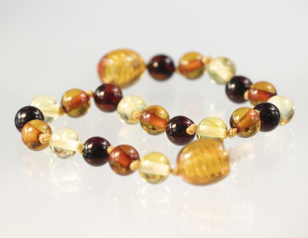

Im attaching both an original picture and an edited picture for you to have a look. Im also attaching a side by side comparison. Thanks

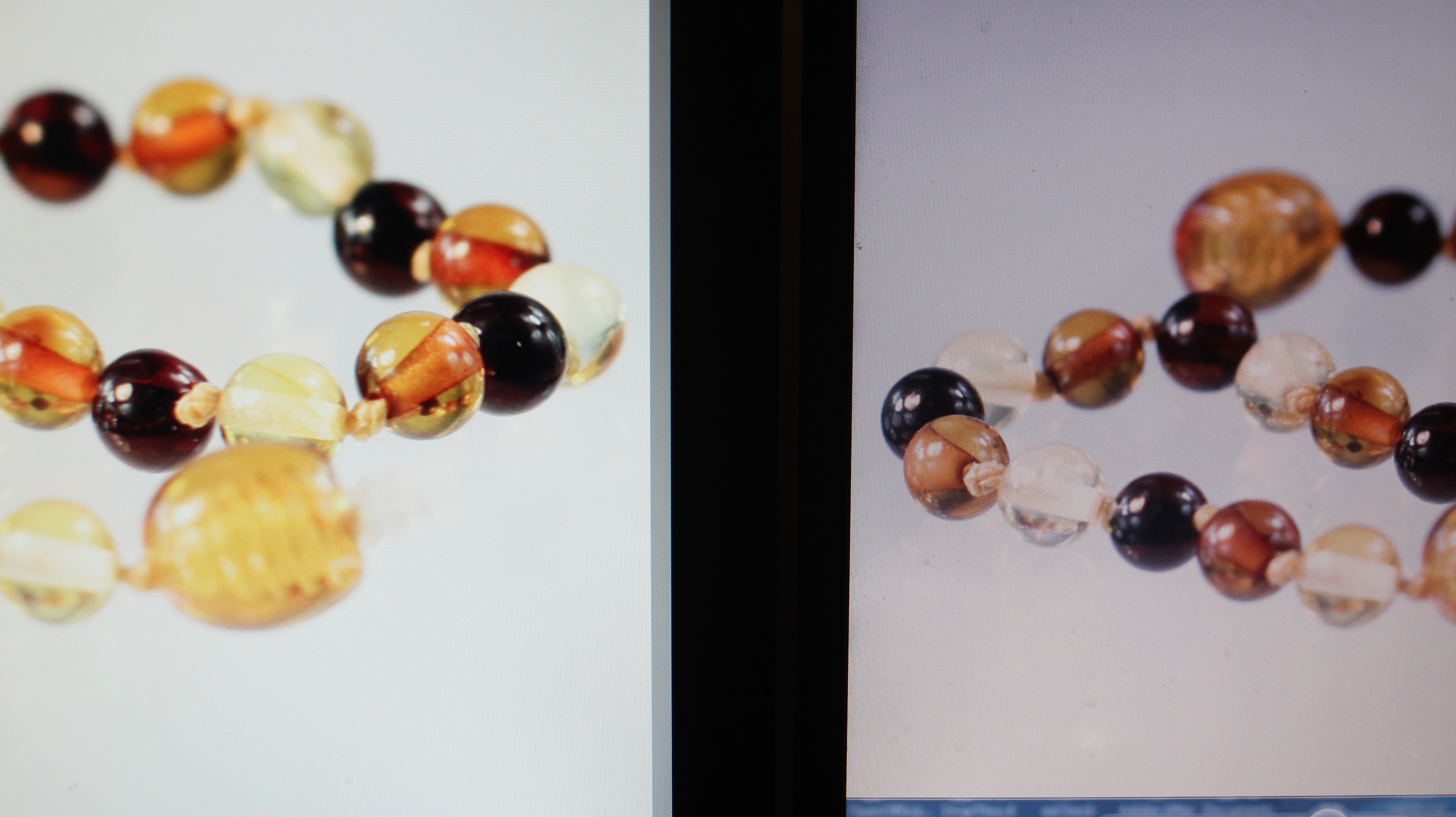

In addition, in the old comparison attachment (which is now gone), the white balance of the two displays is vastly different. The monitor on the right has far lower brightness and a much cooler white balance.

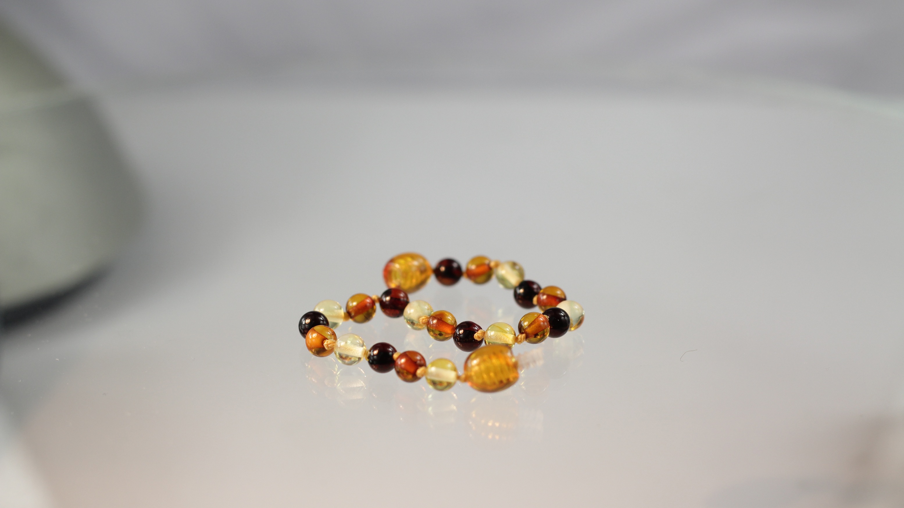

Also that Gamma slider may need to be centred (from your screen shot). I would seem to me that in the default position you should be able to adjust Gamma either up or down. The screen shot seems to indicate that you can only adjust up as it is now. Try putting it at the 0.5 position.

Thank you all for your replies, I tried shifting the gamma in aperture and still no luck.
