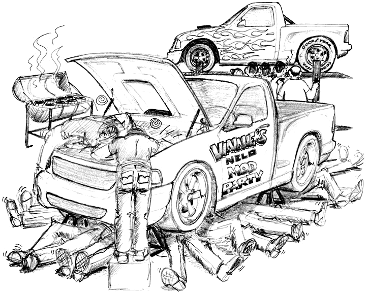

Here's the deal. I pencil sketched a freehand cartoon for a bunch of friends and it's not simply black and white as it has some shading so there are blacks as well as several shades of gray to deal with and wispy lines as well. Also, it's on white paper, and what I'd like to do is somehow make the background yellow, or better yet... transparent so I can place it on different background colors. We're thinking we might want to have the cartoon screened onto a T-shirt. I scanned it on my Epson scanner, but there's no obvious option to make the output a transparent gif. Anyone know how to do this in Photoshop?

The magic wand won't cut it Jessica... so I tried Infinity's suggestions... and I didn't see any yellow even though I spec'd yellow as the color and checked multiply. Here's the image. Like I said... ideal would be to have a GIF file that had a transparent background.

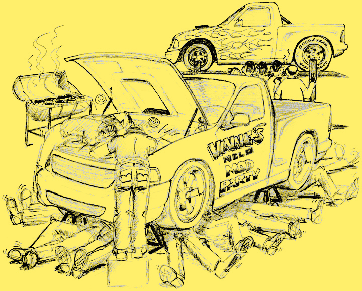

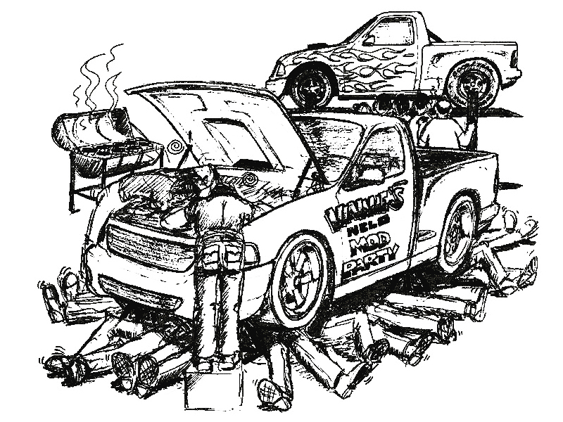

hopefully this is what you were looking for. Transparent and yellows. I just used colour range 😉 simple as that.

Your questions has actually been answered before on this Forum. Don't use the wand. If you go the multiply route, the top layer (either the yellow or the scan) must be multiplied. It will not work if you set yellow to multiply and have it positioned under the scan layer. Don't save as GIF if you plan to print T-Shirts. Save as PSD or TIF (to preserve layers) or PNG-24.

Even though the scan is quite lo-res, will these do?
It's just a matter of using Menu: Select>Select Color Range and trying a low tolerance of about 12-30 while selecting a white area, maybe feathering it very very slightly and then clearing the resulting selection from the layer it's on.
But this file is far too low-res for a decent piece of art. Scan it at 600-900ppi, do a bit of curves on it so that the most solid area is 100% black and try it for yourself.
The rest that Kwill has said about setting the coloured layer to multiply over are correct, but you wouldn't want a file like that for screen-printing... photo-transfer would be OK.
