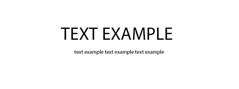

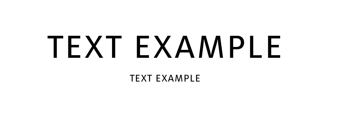

A few days ago I noticed that when I save any image containing text it looks pixelated. I have a 15" Retina MacbookPro and I'm viewing everything at 100%. Also, I made sure that the anti-aliasing was not set to none and I've also tried changing the pixel density, which didn't make any difference.
What intrigues me the most is the fact that this only started happening two or three days ago, which doesn't make any sense since I didn't update Photoshop. I've also didn't change any settings that I'm aware of.
This is really bothering me because I need Photoshop for university as well as for web designing. I'm going to leave some images below to illustrate what I'm trying to say. If anyone could help, I would really appreciate it.
Image in Photoshop:
Image when saved:

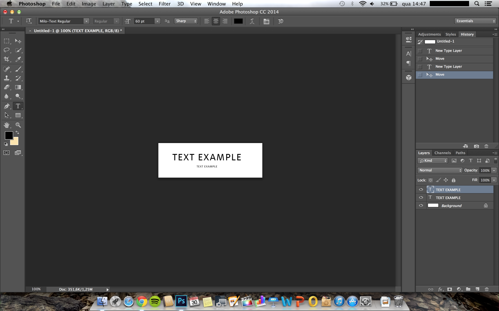

Thanks for the response! I have anti-aliasing on, it is set to sharp. I've also deleted Photoshop preferences, uninstalled and reinstalled it. I have no ideia what's going on.
I analysed your exported image in PS. It has a resolution of 144. Set it back to 72 and enjoy your sharp text. 😉

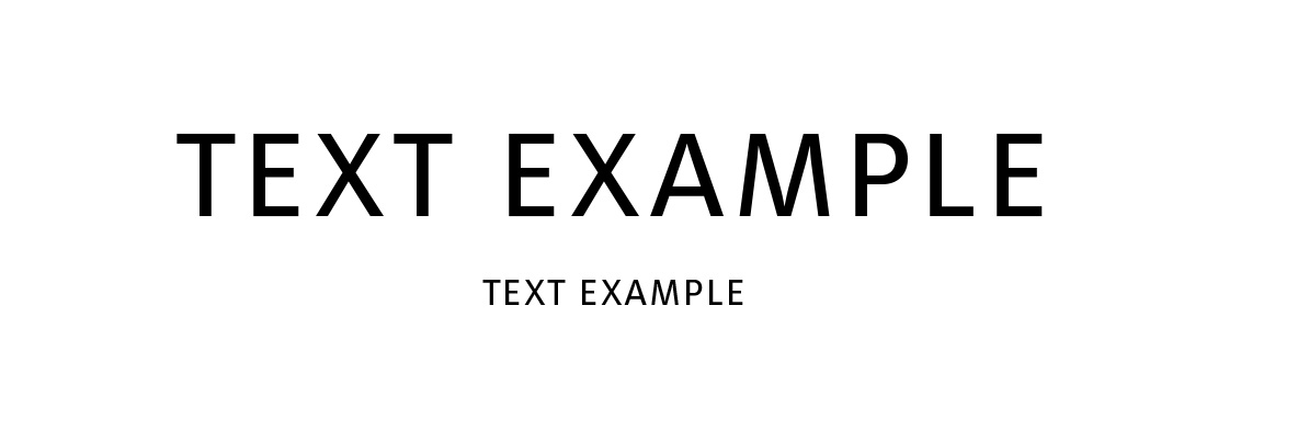

I thought it was at 72. It does make a difference but it's still doesn't seem perfect.
I see no problem with that image. The last thing you could to is tweaking the rendering options, like SwiftLives mentioned before. I would go with 'sharp'. If even that does not satisfy you, the vector-based format svg is your friend.
I think this might be because of the retina screen, on other screens it looks ok. Anyway, thank you so much for the help.

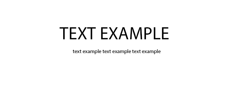

Is this version looking pixelated? FF Milo Regular in Opentype, 50pt kern, and the lower text in 18pt with a 50pt kern as well.
Using the Sharp setting in Anti Aliasing.
Maybe you are using the TTF as opposed to the OTF, you can download the OTF from FontShop or FontFont instead of using the TTF file.
