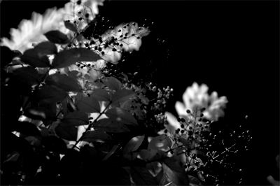

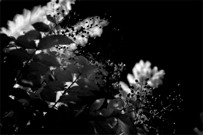

Ok, I followed your advice, although I'm not quite sure that is looks right:
Is this what you had before you added the adjustment layer?
EDIT: Never mind, the reason it wasn't working is it was still in greyscale. A quick switch to RGB and everything seems to be working. The only problem I can see is the sky is black.

No, when I did it, it came out looking exactly like Lab minus the 'a' channel, except it didn't have that hint of color.
That's odd. Your's didn't have a black sky? I think solved the problem though and I have it looking almost how I want it. I just need to play around with the colours a bit more. Thanks for the help.
