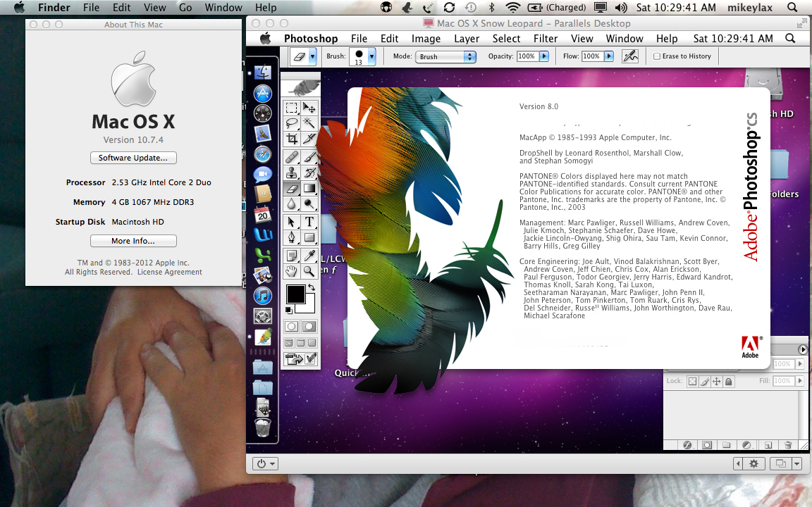

You have three workarounds available to you:
1. Restore your boot OS X to Snow Leopard available for $19.99 directly from Apple.
2. Keep Mt. Lion but partition your hard drive or add an external hard drive and install Snow Leopard and "dual-boot" into Snow Leopard when you want to use CS3. This method will not allow you to have concurrent access to Mt. Lion and CS3.
3. Install Snow Leopard into Parallels (or Lion, if CS3 will work in Lion) for concurrent running of CS3 and Mt.Lion:
[click on image to enlarge]

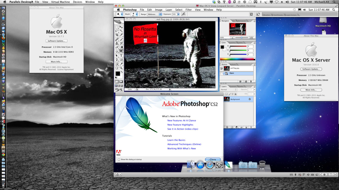

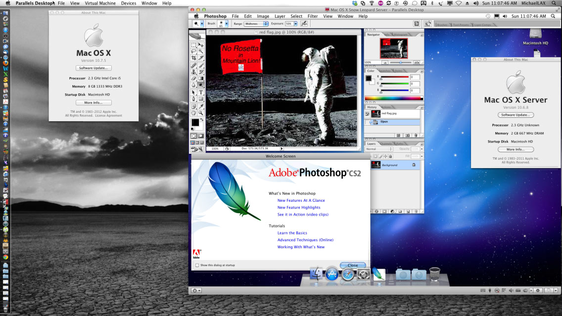

Here is an example of CS2, now downloadable from Adobe for free, running in Snow Leopard Server concurrently with Lion:
