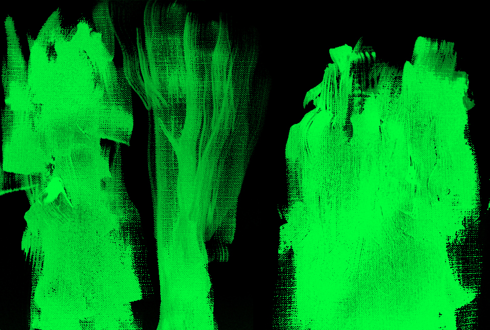

There's no "easy" way to do it. One way I guarantee to fail is the magic wand. It's a matter of building up the areas you want to keep vs. taking away the shadow dot that will persist in the yellow background. Very little of that is achieved through selecting. Almost all of it is achieved through multiplying, screening, overlaying and sharpening the image in grayscale.
Just don't fall for that Magic Wand. It'll break your heart.
