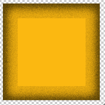

I'm having a problem with the layer styles noise when I flatten or export an image.
I like to use inner shadows with noise to simulate contours and texture. This all works fine when I'm working on a PSD document. Still whenever I flatten an image or save it as a jpg all the noise from the layer style filter is lost and I'm left with a smooth gradient. You can see an example of what I mean in the attachments I included.
Does anyone know how I can retain the noise effect I like? Surely it must be possible or why would there be an a way of adding it in the 1st place?

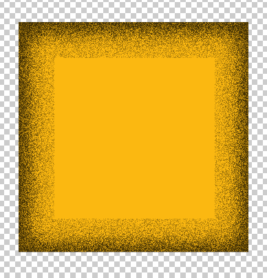

Yes I do the same but when I do this the noise I've added disappears and becomes smooth. See the attachments for an example.
Ho do I retain the noise I like so much ? 🙁

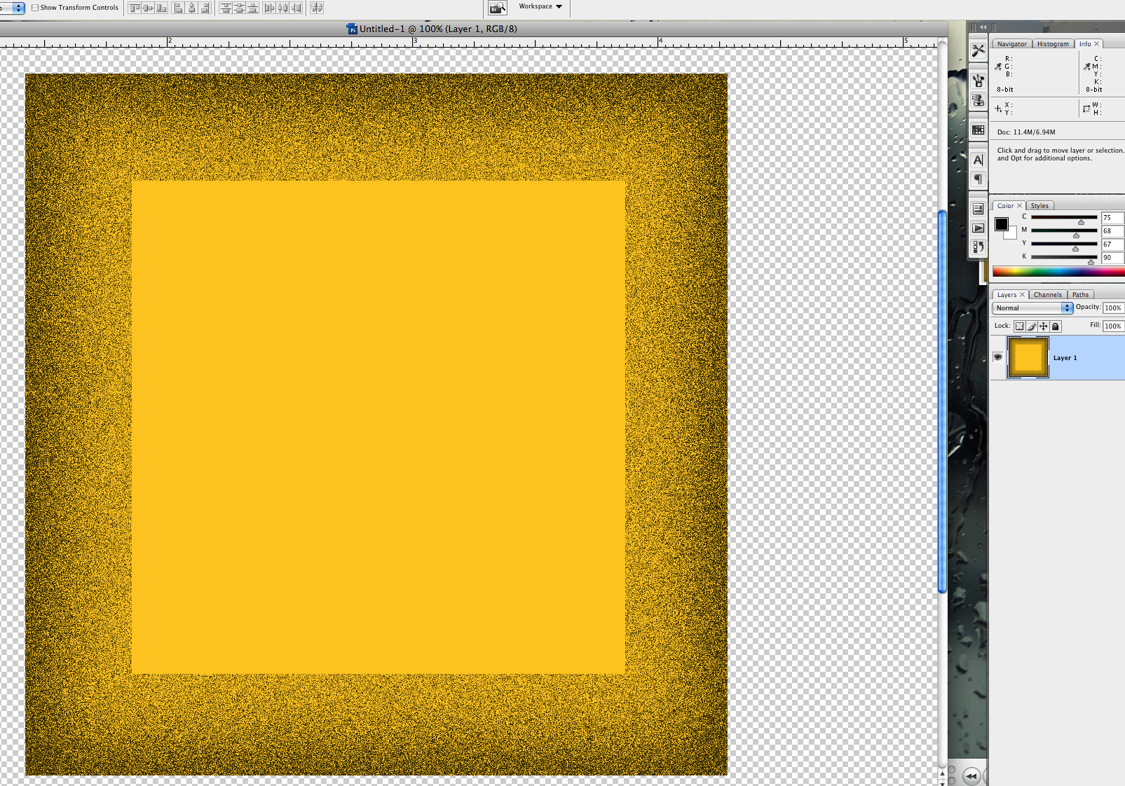

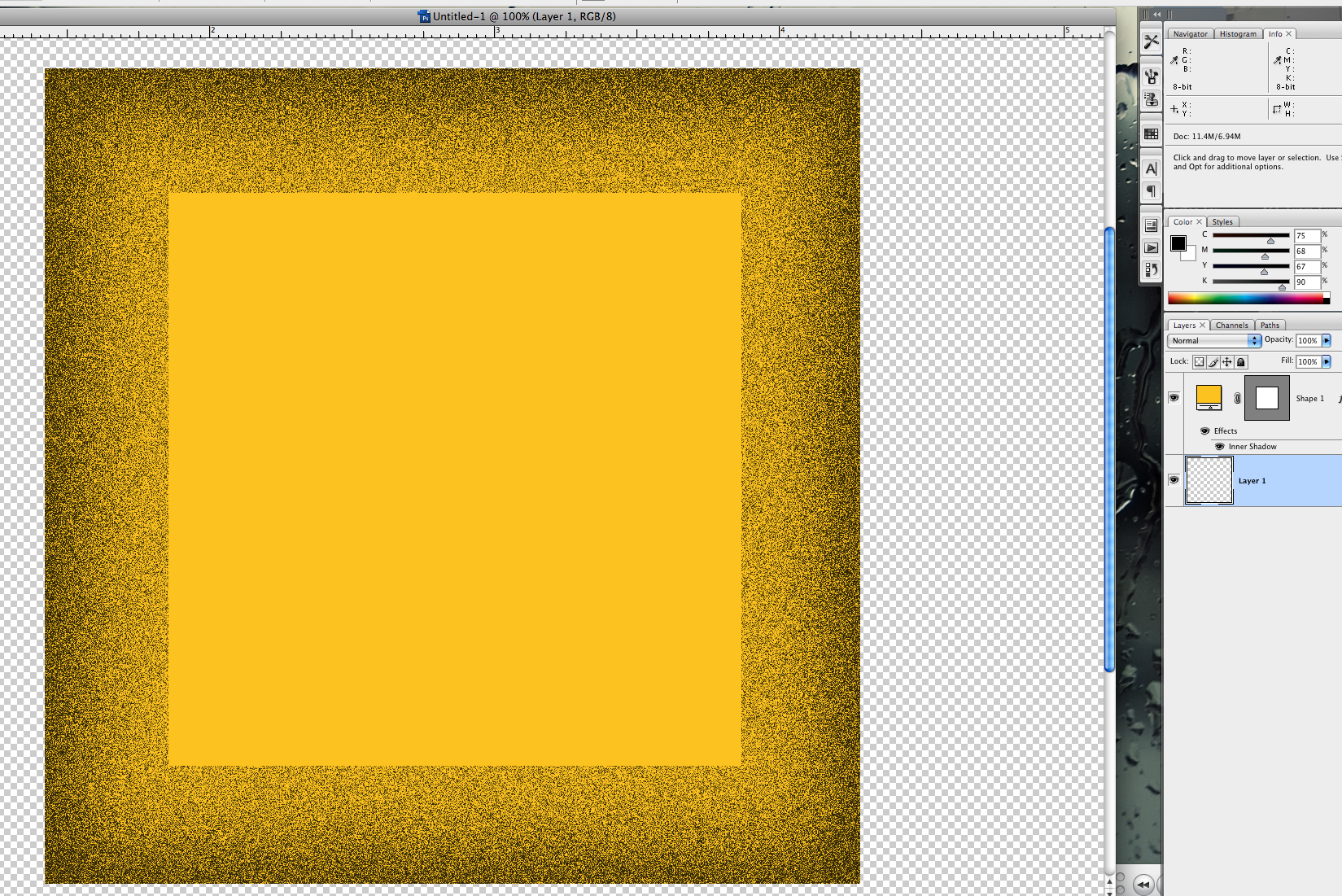

Can I get you guys to try this and see if you have the same experience please.
I made a new document 2000x2000px Res 350 transparent.
I then drew a 1000x1000 pixel square and filled it with a light yellow color.
Then in Blending Options / Inner Shadow
I then put in the following
Choke 30
Size 150%
Noise 50%
You should now have a light yellow square with a very noisy Inner Shadow.
Not make a new layer and merge them together.
For me what happens is the noise is significantly reduced but not altogether lost.
Why does it change at all?

To my understanding
As far as I know, It looses its bunch and "darkness" because you are rasterizing the image when you merge the two layers? If it is so crucial, maybe after you merge the layers, just adjust the contrast on the newly flattened layer until it suits your need.
While it appears to change when I'm looking at it from 33% or 50%, when I am at 100% and merge the layers, there is no apparent change.

Ok so yes at 100% there seems to be no change for me as well.
So the problem isn't so much the rastering of the filter but the visible display of the filters effect at different zoom levels?
